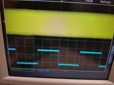

I first tried to have the blinck program working when the dev board is NFC power.
So program the chip vian LCP link, then disconnect and apply the NFC filed.
 The program runs well.
Here is an image of the NFC received field on the dev board (yellow), below signal on PIO0_2.

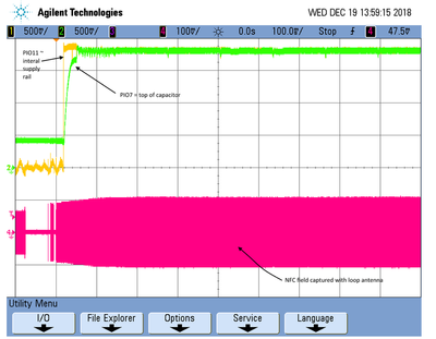

Since in my application, the NHS3152 will have to light 3 red LEDs (with voltage bias at 1.6V and each with a current varying from 0 up to 1mA), I need to use a capacitor to store voltage.
Basically I want to reproduce image below from post
NHS3152 power only from NFC field and load Capacit... - NXP Community
So according to one post and the datasheet I use a 330nF cap with a pull-up resistor of 3.3kOhms to slowly charge the cap.

This is not working, I basically dont’ see any change on the voltage cap value.
Is the program not working ?

CyrilBZH
Hello Patrick,
ok it works! The problem came from my oscilloscope probe.
