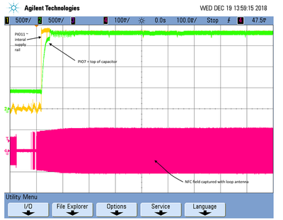

Here is an image of the NFC received field on the dev board (yellow), below signal on PIO0_2.
Since in my application, the NHS3152 will have to light 3 red LEDs (with voltage bias at 1.6V and each with a current varying from 0 up to 1mA), I need to use a capacitor to store voltage.
Basically I want to reproduce image below from post
NHS3152 power only from NFC field and load Capacit... - NXP Community

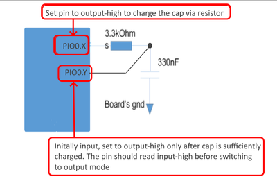

So according to one post and the datasheet I use a 330nF cap with a pull-up resistor of 3.3kOhms to slowly charge the cap.
Here is a schematic of my circuit :
I used the following program

This is not working, I basically dont’ see any change on the voltage cap value.
Is the program not working ?

Hi CyrilBZH,
The cap needs a low ohmic connection to the pad, so no external series resistor. It can be slowly charged via the internal pull-up in the same pad (but this has a fixed 70k+ resistance).
For more flexibility an extra pad + external resistor can be used, as shown in the drawing below.
The pad transistors have a non negligible impedance, so the buffering performance of the external cap may be impaired.

Hello Patrick,
ok it works! The problem came from my oscilloscope probe.
All the best
