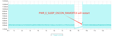

Hello, we know that in JN5189 sleep a total of PWR_E_SLEEP_OSCON_RAMON = 1, /*32Khz osc on and ram on*/
PWR_E_SLEEP_OSCON_RAMOFF = 2, /*32Khz Osc on and Ram off*/
PWR_E_SLEEP_OSCOFF_RAMON = 5, /*32Khz Osc off and Ram on*/
PWR_E_SLEEP_OSCOFF_RAMOFF = 6, /*32Khz Osc off and Ram off*/
Four modes,
when I change the sleep mode from PWR_E_SLEEP_OSCOFF_RAMOFF to PWR_E_SLEEP_OSCON_RAMOFF.JN5189 cannot sleep, when performing PWR_ChangeDeepSleepMode (PWR_E_SLEEP_OSCON_RAMOFF); The system will restart , do I need to make other configurations in this mode? Why does the system restart as soon as it is executed?
I want it to sleep all the time, and then I pass wake-up clock function : WTIMER_StartTimerLarge(1, 128000); Wake up the system.

Hello, I have successfully compiled AN-1243 v2.7 using SDK2.6.8 this afternoon. But the same problem still exists, sleep can be normal when the sleep mode is set to PWR_ChangeDeepSleepMode(PWR_E_SLEEP_OSCOFF_RAMOFF)
If the sleep mode is PWR_ChangeDeepSleepMode(PWR_E_SLEEP_OSCON_RAMOFF), the system will restart.
The code I changed is as follows, and I changed it in the APP_cbTimerPoll function of app_end_device_node.c.

Hello, I have used the SDK version 2.6.13 today to compile the latest AN1243 file, but the result is still the same.When sleep mode is  PWR_E_SLEEP_OSCON_RAMOFF the system will restart.
I guess this shouldn't be an issue with the SDK version, but if you have time, I'd like you to test it out and share your results with me.

qianchihuang
The picture I just used was wrong, and the picture I tested today is as follows.
