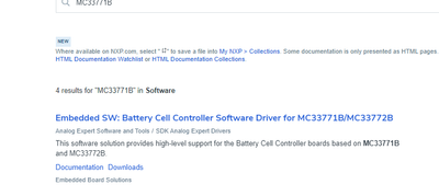

guoweisun
You can sign NDA then download it in the NXP website.

guoweisun
You can try to directly download it!

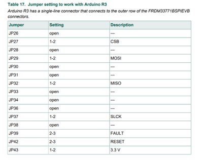

ashutosh_saxena
It shows Arduino as an option in Eval GUI, but it is not selectable. How can I solve this?
10,975 Views
guoweisun
You can try to re-set the jumper in the FRDM33771BSPIEVB.
10,973 Views
ashutosh_saxena
Tried that multiple times, but it is not acknowledging Arduino even after updating the port in device manager.
