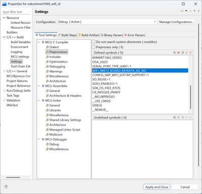

I am trying to get WiFi to work with the help of Getting Started with the MIMXRT1060-EVK, but the file structure included in the WiFi example project installed in the IDE using the import SDK example has changed significantly. There is no app_config.h and I can't find the file defining the WiFi module to use. Is there another SDK file?

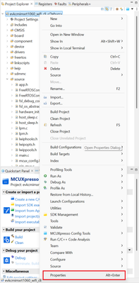

Hello shaun_wu,
Thank you for responding to my question.
I am not sure how to get that settings window. Could you let me know about it?

I have an additional information for this question. I use MCUXpresso IDE v25.6.136 and have got this issue.
I check this with IDE v24.12.148 and can see the file app_config.h in the directory 'source'. So I guess this is a bug in v25.

shaun_wu
Hello @AKobamasa
You could refer to following image:

shaun_wu
Hello @AKobamasa
You could find it in marco definition of project:

AKobamasa
Hello shaun_wu
I succeeded to build and run the project with this setting in MCUXpresso v25.
Thanks a lot.
