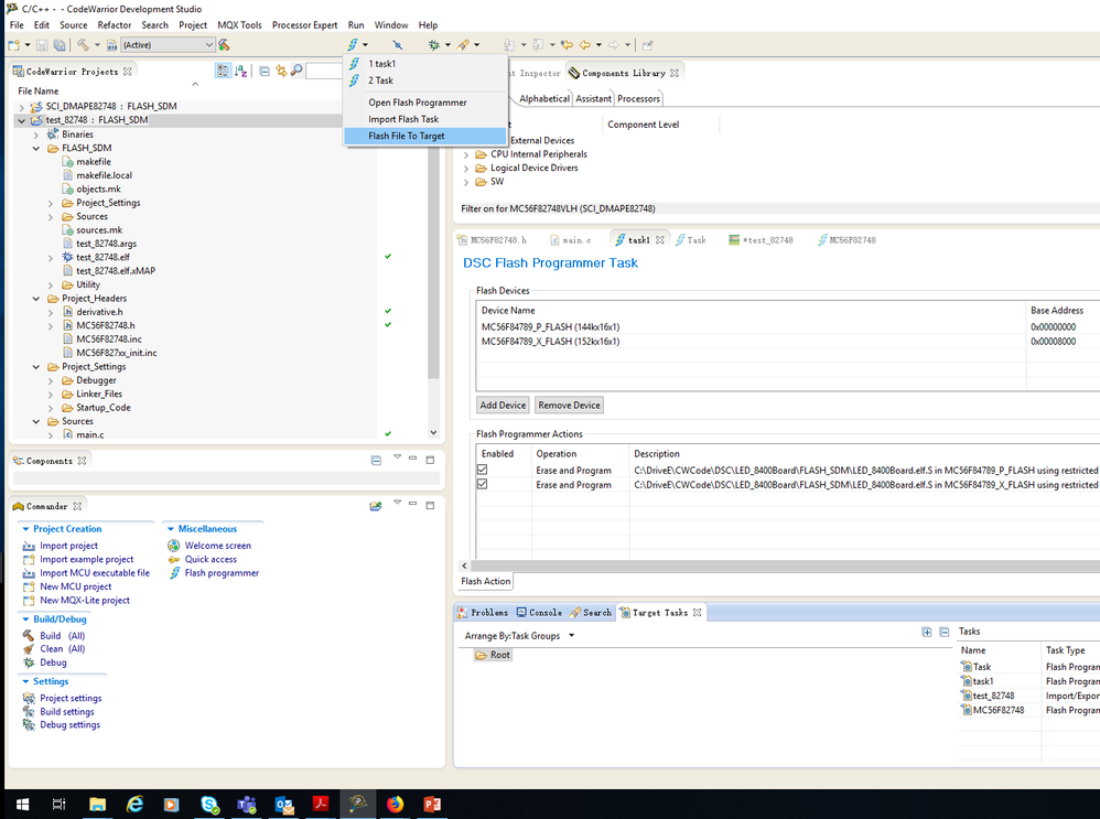

Regarding your question, of course, the CodeWarrior for mcu ver11.x tools provides the Flash programming function, pls refer to the following screenshot:
Pls have a try.

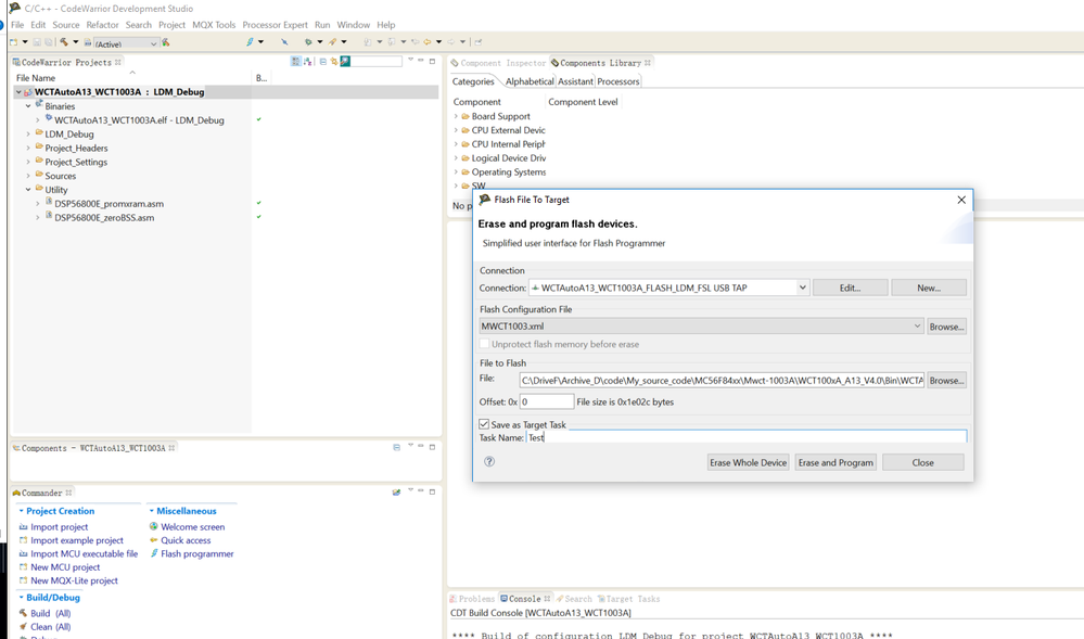

After you click the "Flash File to Target", you can follow up  the the following configuration to erase/program the application for the MWCT1013VLH IC.
Hope it can help you
XiangJun Rong
