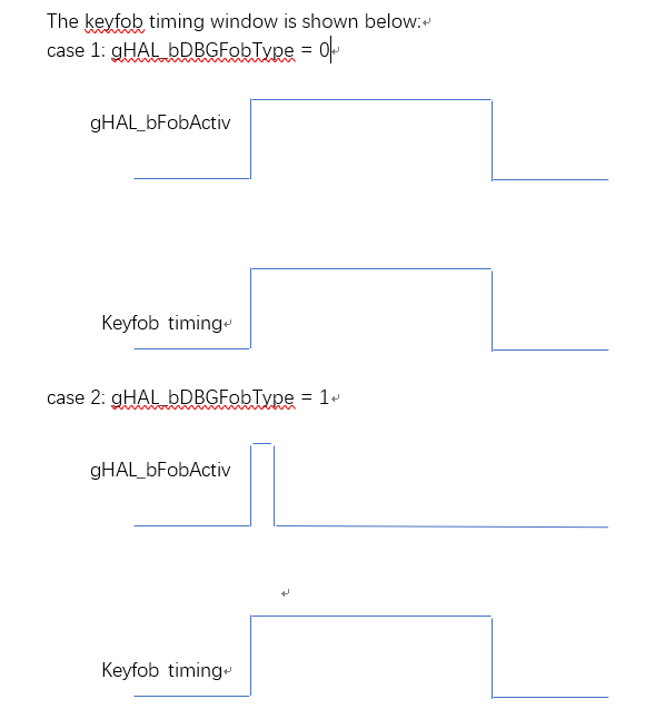

This is follow up question for this case.
https://community.nxp.com/message/1212814?commentID=1212814&et=watches.email.thread#comment-1212814
a)
I confirmed that TX changed its operation frequency by setting gHAL_bFobActive =1 in power transfer state.
However, this method came to enforce TX to change its operational frequency by FreeMASTER.
I want to check if TX is able to detect a real smart key for car entry and TX change its operational frequency after the detection
What I should do in this case ?
Could you tell me how to evaluate keyfob avoidance function by using the real smart key for car entry in NXP reference board ?
b)
Regarding gHAL_bDBGFobType, there are "level effectively" and "edge effectively".
What is difference between " level effectively " and " edge effectively" ?
How can I evaluate  " level effectively " and " edge effectively" in NXP reference board ?
c)
 NXP reference board has three coils as TX coil.
 I modified the board to use single coil instead of thee coil.
 When I installed the program "WCT-15WTXAUTO_V4.0" into the micro controller "MWCT1013AVLH",
 TX with single coil was able to charge but could not charge when I installed the program "WCT-15WTXAUTO_V4.1".
 Could you tell me how to make TX with single coil work even if I use the program "WCT-15WTXAUTO_V4.1" ?
Norihiro Michigami
AVNET
1 解答
1,627 次查看
xiangjun_rong
Hi, Norihiro,
This is the reply from AE team.
XiangJun Rong
a) NXP only provide API (HAL_CheckFobActive). gHAL_bFobActive =1 is only for test. When the API return TRUE, libray will change operation frequency. So keyfob feature should be implemented by customer for real smart key.
b) When gHAL_bDBGFobType is set 0, keyfob frequency will last when gHAL_bFobActiv is 1.  If gHAL_bFobActiv change to 0, frequency will change to normal value.
When gHAL_bDBGFobType is set 1, library will change frequency when gHAL_bFobActiv change to 1 from 0, then keyfob frequency will keep for gHAL_wDBGFobDuration, no matter what state of gHAL_bFobActiv.keyfob.png
c) I don't know cutomwer how to change code for single coil, but it should be work for V4.1.  The method is same.

Hi, Norihiro,
XiangJun Rong
