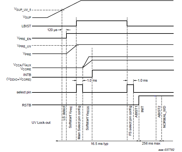

1:I confirmed if IO_X below 8V,the SBC can start up normally.
In you case, do you know which phase get stuck during start up? you can match below startup timing? perhaps ABIST1 detect error.
2:If you set IO_2=0 ,IO_0=5V,then power the SBC does it can startup each time?

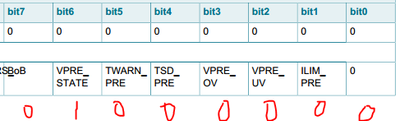

snaku_lee
Hi GW,
When the 1st power on, MCU read below registers' values,
FS45_FS_INIT_FSSM_ADDR [0x25]  = 0x08
FS45_M_DIAG_VPRE_ADDR [0x0C] = 0x40
FS45_M_DIAG_VCORE_ADDR [0x0D] = 0x00
FS45_M_DIAG_VCCA_ADDR [0x0E] =0x00
FS45_M_DIAG_VAUX_ADDR [0x0F] = 0x00
FS45_M_DIAG_VSUP_VCAN_ADDR [0x10] = 0x00
FS45_M_DIAG_SPI_ADDR [0x13] = 0x00
FS45_FS_DIAG_SF_IOS_ADDR [0x2D] = 0x00
And I find more symptoms of this issue,
1. While IO_2 = 5V, let SBC enter low power mode (sleep), then wake up by IO_0, this issue will happen too.
2. When this issue happens (SBC doesn't release RSTB), remove IO_2, then SBC will release RSTB.
Snaku

guoweisun
