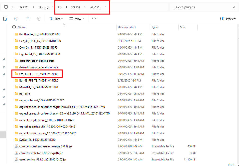

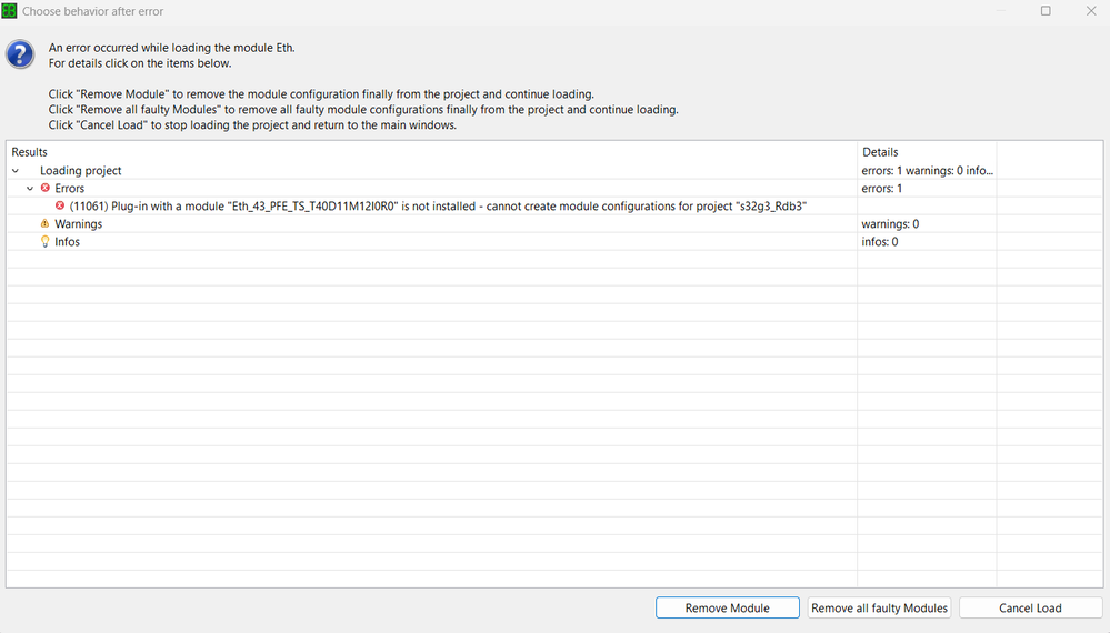

I want to open a project on EB, the EB version i am using is 27.1.0. When I tried to open the module, an error pop up as below, it says Eth_43_PFE_TS_T40D11M12I0R0 is not installed:

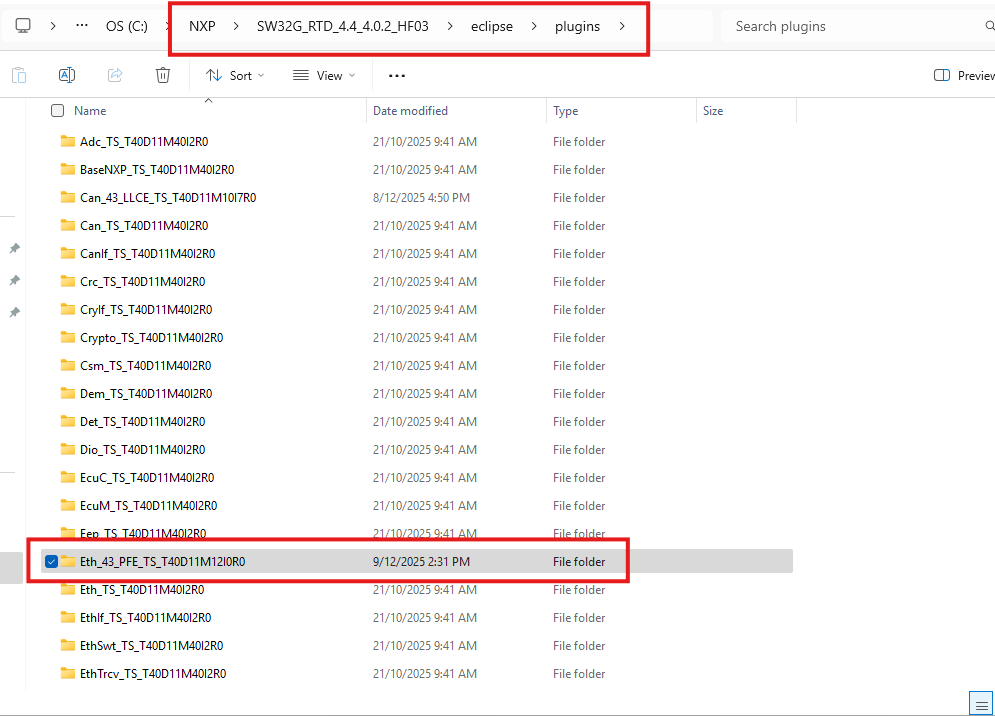

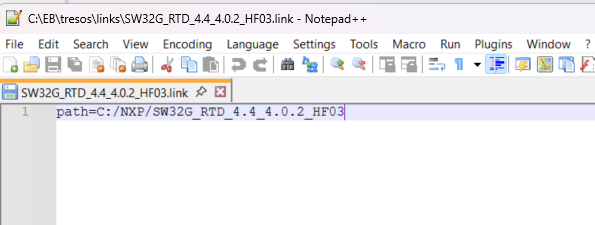

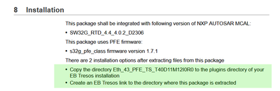

I understanding when installing the EB tresos, I should link to the RTD folder, I indeed did:
Besides, I also cope paste the Eth_43_PFE_TS_T40D11M12I0R0 to RTD folder and EB plugins folder:
All the above actions make no difference, the error stays.
Do I miss some setup?

  • Remove the link file and use only the copied plugins in the Tresos directory. The S32G MCAL Driver Release Notes for version 1.2.0 mention the installation methods as mutually exclusive:

PS C:\NXP\SW32G_RTD_4.4_4.0.2_HF03\eclipse\plugins> Get-ChildItem -Depth 0
    Directory: C:\NXP\SW32G_RTD_4.4_4.0.2_HF03\eclipse\plugins
Mode                 LastWriteTime         Length Name
d-----     12/12/2025  04:47 p. m.                Adc_TS_T40D11M40I2R0
d-----     12/12/2025  04:48 p. m.                BaseNXP_TS_T40D11M40I2R0
d-----     12/12/2025  04:48 p. m.                CanIf_TS_T40D11M40I2R0
d-----     12/12/2025  04:48 p. m.                Can_TS_T40D11M40I2R0
d-----     12/12/2025  04:48 p. m.                Crc_TS_T40D11M40I2R0
d-----     12/12/2025  04:48 p. m.                CryIf_TS_T40D11M40I2R0
d-----     12/12/2025  04:48 p. m.                Crypto_TS_T40D11M40I2R0
d-----     12/12/2025  04:48 p. m.                Csm_TS_T40D11M40I2R0
d-----     12/12/2025  04:48 p. m.                Dem_TS_T40D11M40I2R0
d-----     12/12/2025  04:48 p. m.                Det_TS_T40D11M40I2R0
d-----     12/12/2025  04:48 p. m.                Dio_TS_T40D11M40I2R0
d-----     12/12/2025  04:48 p. m.                EcuC_TS_T40D11M40I2R0
d-----     12/12/2025  04:48 p. m.                EcuM_TS_T40D11M40I2R0
d-----     12/12/2025  04:48 p. m.                Eep_TS_T40D11M40I2R0
d-----     12/12/2025  04:48 p. m.                EthIf_TS_T40D11M40I2R0
d-----     12/12/2025  04:48 p. m.                EthSwt_TS_T40D11M40I2R0
d-----     12/12/2025  04:48 p. m.                EthTrcv_TS_T40D11M40I2R0
d-----     15/12/2025  03:08 p. m.                Eth_43_PFE_TS_T40D11M12I0R0
d-----     12/12/2025  04:49 p. m.                Eth_TS_T40D11M40I2R0
d-----     12/12/2025  04:49 p. m.                Fee_TS_T40D11M40I2R0
d-----     12/12/2025  04:49 p. m.                Fls_TS_T40D11M40I2R0
d-----     12/12/2025  04:49 p. m.                FrIf_TS_T40D11M40I2R0
d-----     12/12/2025  04:49 p. m.                Fr_TS_T40D11M40I2R0
d-----     12/12/2025  04:49 p. m.                Gpt_TS_T40D11M40I2R0
d-----     12/12/2025  04:49 p. m.                I2c_TS_T40D11M40I2R0
d-----     12/12/2025  04:49 p. m.                Icu_TS_T40D11M40I2R0
d-----     12/12/2025  04:49 p. m.                LinIf_TS_T40D11M40I2R0
d-----     12/12/2025  04:50 p. m.                Lin_TS_T40D11M40I2R0
d-----     15/12/2025  03:08 p. m.                Mcl_TS_T40D11M40I2R0
d-----     12/12/2025  04:50 p. m.                Mcu_TS_T40D11M40I2R0
d-----     12/12/2025  04:50 p. m.                MemIf_TS_T40D11M40I2R0
d-----     12/12/2025  04:50 p. m.                Ocotp_TS_T40D11M40I2R0
d-----     12/12/2025  04:50 p. m.                Ocu_TS_T40D11M40I2R0
d-----     12/12/2025  04:50 p. m.                Os_TS_T40D11M40I2R0
d-----     12/12/2025  04:50 p. m.                Pcie_TS_T40D11M40I2R0
d-----     12/12/2025  04:50 p. m.                Platform_TS_T40D11M40I2R0
d-----     12/12/2025  04:50 p. m.                Pmic_TS_T40D11M40I2R0
d-----     12/12/2025  04:50 p. m.                Port_TS_T40D11M40I2R0
d-----     12/12/2025  04:50 p. m.                Pwm_TS_T40D11M40I2R0
d-----     12/12/2025  04:50 p. m.                Qdec_TS_T40D11M40I2R0
d-----     12/12/2025  04:50 p. m.                Resource_TS_T40D11M40I2R0
d-----     12/12/2025  04:50 p. m.                Rm_TS_T40D11M40I2R0
d-----     12/12/2025  04:50 p. m.                Rte_TS_T40D11M40I2R0
d-----     12/12/2025  04:50 p. m.                Serdes_TS_T40D11M40I2R0
d-----     12/12/2025  04:50 p. m.                Spi_TS_T40D11M40I2R0
d-----     12/12/2025  04:50 p. m.                Thermal_TS_T40D11M40I2R0
d-----     12/12/2025  04:50 p. m.                Uart_TS_T40D11M40I2R0
d-----     12/12/2025  04:50 p. m.                WdgIf_TS_T40D11M40I2R0
d-----     12/12/2025  04:51 p. m.                Wdg_43_VR5510_TS_T40D11M40I2R0
d-----     12/12/2025  04:51 p. m.                Wdg_TS_T40D11M40I2R0
-a----     22/08/2024  10:06 a. m.           2746 com.freescale.tools.tresos.xpath.jar
-a----     22/08/2024  10:23 a. m.           1757 com.nxp.tools.tresos.xpath.sqrt.jar
-a----     22/08/2024  10:31 a. m.          29240 freescale.tresos.flexray.jar
Then you can compare if there is any relevant difference in our plugin installation.
If you do not find any important difference, I would recommend trying reinstalling EB Tresos, if you have not already.
Please let me know if you find any information that might help me narrow down the problem.
