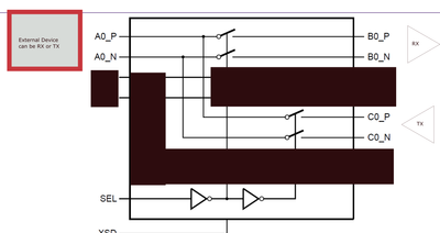

Dear NXP Community,
is it possible to switch with the IC the RX/TX direction only using the first channel.
A 150 MHz LVDS CLK shall be transmitted or received, depending on state of the select pin.
Thank you
Kind regards
Moritz

Dear Mr. Vischer,
Yes, the CBTU02043HE can be used to switch a 150 MHz LVDS clock signal between transmit and receive directions using just one differential channel, controlled by the SEL pin.
BRs, Tomas

Thank you very much. I just wanted to be sure.
