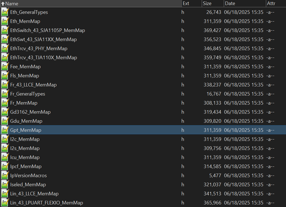

Hello, I would like to inquire about how to generate MemMap header files (e.g., Gpt_MemMap.h) for modules in the Autosar MCAL environment. Are there specific tools or configuration steps required to complete this? Looking forward to your reply. Thank you!

The header files are distributed with S32K1xx RTD drivers.
Use the latest S32K1xx RTD 3.0.0 and S32DS 3.6 IDE.
The RTD can be installed in S32DS IDE 3.6 from this file:
SW32K1_S32M24x_RTD_R21-11_3.0.0_D2503_DesignStudio_updatesite.zip
You can then find all the header files in this directory:
\S32DS\software\PlatformSDK_S32K3\RTD\BaseNXP_TS_T40D34M30I0R0\include\
You can also install the standalone version of the drivers:
SW32K1_S32M24x_RTD_R21-11_3.0.0_D2503.exe
The header files are in the same directory.
The MCAL configuration can be generated in S32DS IDE 3.6 or by other EB Tresos.

Thank you for your previous reply. I'm aware that the MemMap header files for MCAL modules can be found in the directory \S32DS\software\PlatformSDK_S32K3\RTD\BaseNXP_TS_T40D34M30I0R0\include.
What I'd like to further clarify is: Are these header files written manually? Or are they generated by a specific tool? If they are generated, what is the generation process? I'm interested in generating these MemMap header files myself, so could you please let me know how these header files are created?

These files were created by the RTD development team and are not user-generatable.
Users do not have the capability to generate these files manually, as they are part of the official RTD release and provided directly by the developers.
