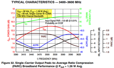

diazmarin09
I hope all is great with you.
Please review the typical characteristics below:
You may find further information about all its frequency range at AFT27S010N datasheet.
I hope this information helps.
David

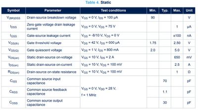

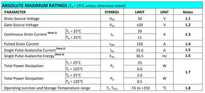

alleniub
2022-09-09 010031.jpg2022-09-09 010031.jpg2022-09-09 011742.jpg2022-09-09 011742.jpg
I mean is there a maximum drain current like the above table, I just want to make sure my simulation drain current 2A is ok .
