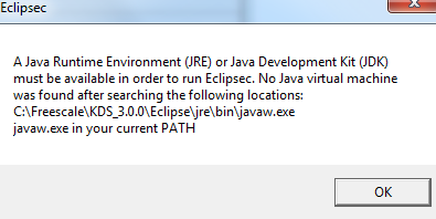

Hi pgo, I need help,
When install USBDM 4.11.1.60 the folder (...\jre\...) does not exist and it can´t install the USBDM plugins, see the error:

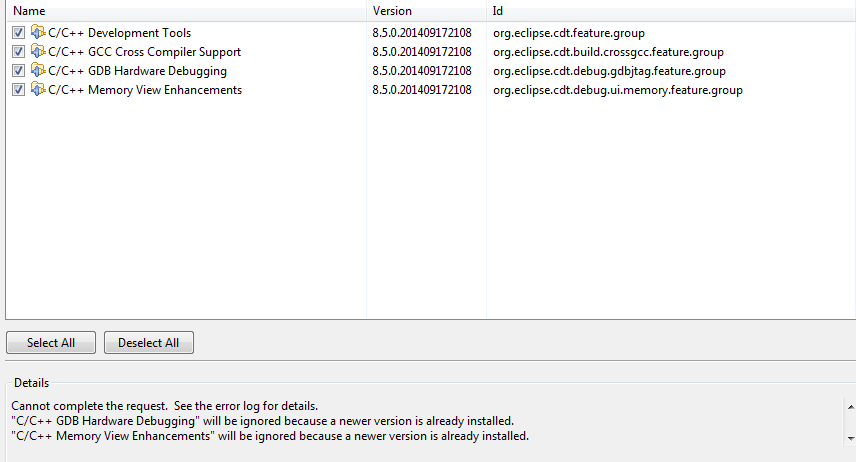

I tried to install this with no success:
C/C++ Development Tools             x.x.x.xxxxxxxxxxxx
C/C++ GCC Cross Compiler Support    x.x.x.xxxxxxxxxxxx
C/C++ GDB Hardware Debugging        x.x.x.xxxxxxxxxxxx
C/C++ Memory View Enhancements      x.x.x.xxxxxxxxxxxx
when install KDS3.0 is it need to install "Eclipse LUNA CDT"?
How can I solve it?

Now I solded it, I found the javaw.exe and copying all this folder:
C:\Freescale\KDS_3.0.0\eclipse\features\com.somniumtech.jre.win32.win32.x86_1.7.0.76\jre
and past it as a new folder:
C:\Freescale\KDS_3.0.0\eclipse\jre
then the USBDM installation software can find the folder and install the plugin correctly.

pgo
Senior Contributor V
Hi Luciano,
A simpler solution would be to install a java jre from https://java.com/en/download/
I didn't realise this would be a problem as I already have java installed.  The only workaround that seem sensible are:
  • Install a java jre Download Free Java Software
  • Manually add the update site afterwards and manually install the plugins - it's not very complicated but a bit of a nuisance.
Ok - A simple solution: Copy kinetis-design-studio.ini to eclipse.ini or use the new version 4.11.1.70.
