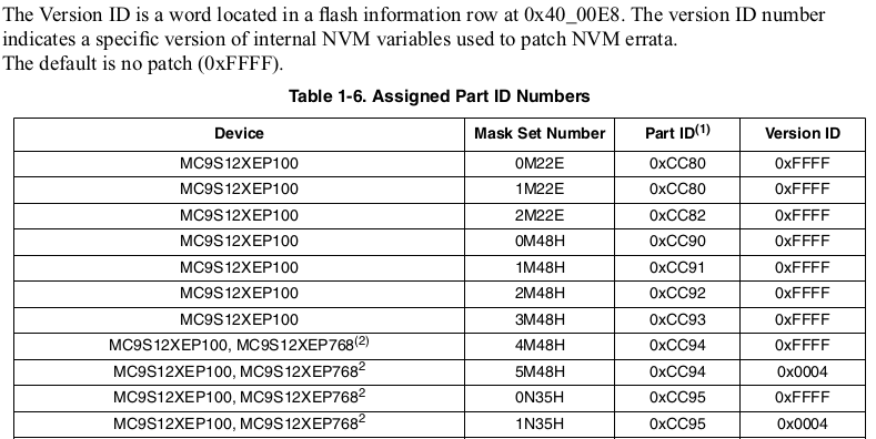

Firstly it detects cc92 as an id. but according to the table that is not right:
and in this post with a similar chip it was cc94
https://community.nxp.com/t5/OSBDM-and-TBDML/Erasing-and-Flashing-mc9s12xep768/m-p/1754397
If this was so then the way it tries to access might be different causing it to fail. Perhaps this information is in hcs12_devices.xml.

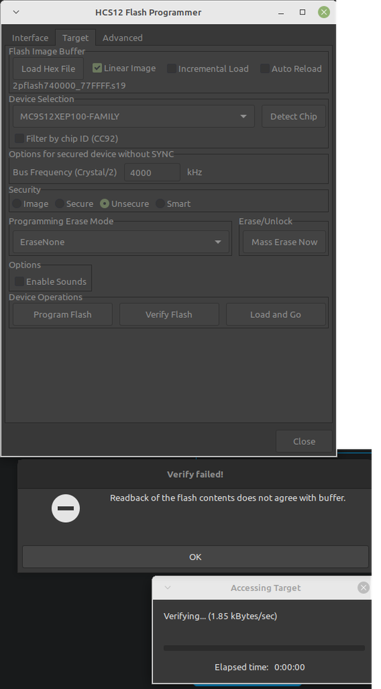

If I unselect what HC12S id chooses and use xep 100 then it starts to read but gives the following message:

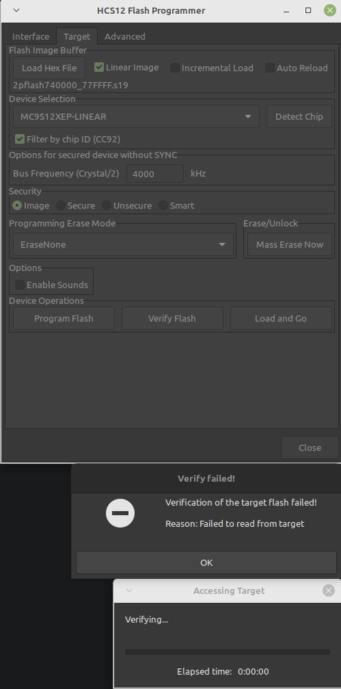

This is the message I get when HC12S chooses the processor xep linear cc92

The chip I have is a MC9S12XEP100 and identifies as CC94.

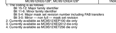

Note the info at the bottom of the table:
The last few bits are described as minor mask set revision and are ignored in the XML file (sdidMask).
Several SDID are treated as equivalent for MC9S12XEP100-family and MC9S12XEP-Linear:
         <sdidMask value="0xFFF0" />

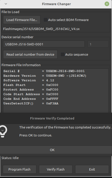

It was new and I did update the Firmware to 4.12.2. The Firmware verify is as follows:
