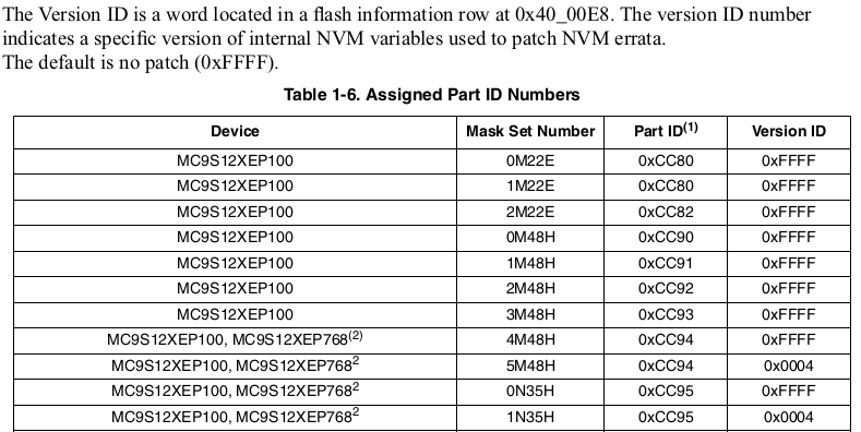

Firstly it detects cc92 as an id. but according to the table that is not right:
and in this post with a similar chip it was cc94
https://community.nxp.com/t5/OSBDM-and-TBDML/Erasing-and-Flashing-mc9s12xep768/m-p/1754397
If this was so then the way it tries to access might be different causing it to fail. Perhaps this information is in hcs12_devices.xml.

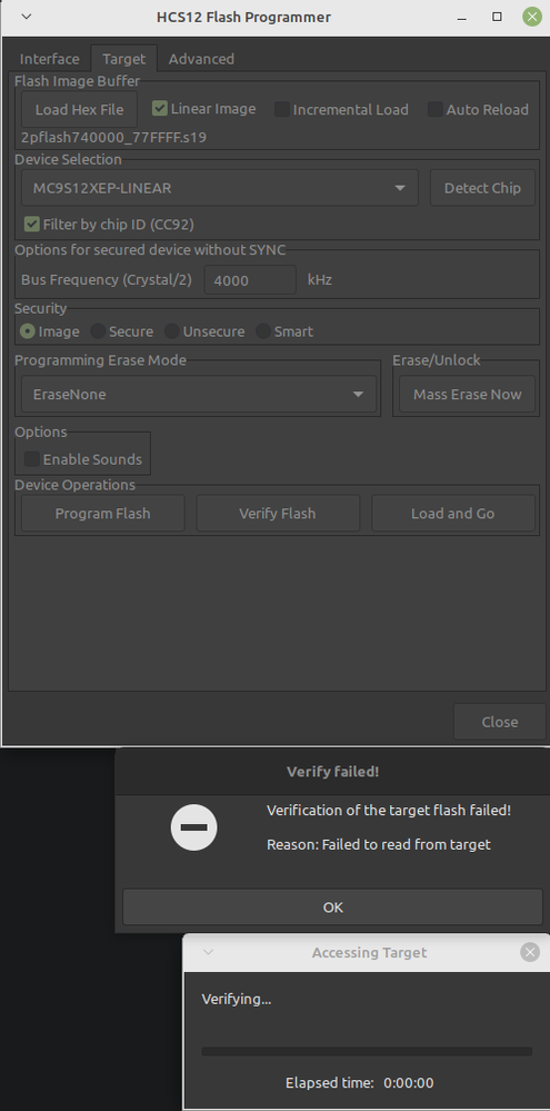

If I unselect what HC12S id chooses and use xep 100 then it starts to read but gives the following message:
Secondly I have checked and a ceramic resonator appears to provide an 8MHz clock which I measured rather approximately on an oscilloscope -  so I wondered what is the rate at which the processor BDM communicates with the usbdm device? -  it seems 250KHz according to MemoryDump. otherwise if it was 4MHz then maybe my Dupont type leads are not sufficient.
There is only a decoupling capacitor on the reset pin on examination no external watchdog.
This is the message I get when HC12S chooses the processor xep linear cc92

The chip I have is a MC9S12XEP100 and identifies as CC94.
Note the info at the bottom of the table:
The last few bits are described as minor mask set revision and are ignored in the XML file (sdidMask).
Several SDID are treated as equivalent for MC9S12XEP100-family and MC9S12XEP-Linear:
         <sdidMask value="0xFFF0" />
         <sdid value="0xCC80" />
         <sdid value="0xCC90" />
         <sdid value="0xC480" />
         <sdid value="0xC080" />
An 8MHz clock leads to an BDM interface frequency of 4MHz.
The Communication Speed selection in memory dump is not used for HCS12.  It is there for some other targets.
Really clutching at straws here but how long is the ribbon cable on the BDM?
Check for noise on the power supply.
bye
