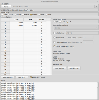

The XEP supports global addresses so it is easier to do them than paged addresses.
The above settings include the EEPROM (DFlash) and PFlash.
You will need to adjust the ranges to accommodate the specific chip variant you have. The above was tested with a MC9S12XEP100 which has the full 1-24 KByte flash. Use the manual to check the memory ranges using the above as a starting point.
To program the device select MC9S12XEP-linear.
To partially verify your captured image I suggest you use the programmer with the original chip and Verify Flash.  Obviously don't program the device!

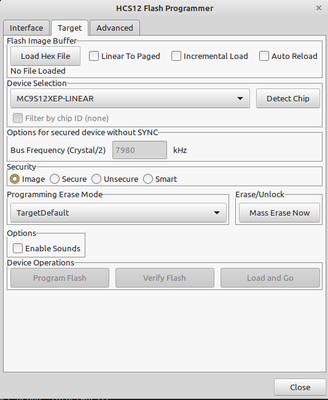

Can you do the following sequence so that I have a know comparison:
  • Load flash image
  • Detect Chip
  • Verify

I've done the sequence Load flash image, Detect Chip, Verify with linear image option not selected followed by with selected. The interface options of reconnect and guess target speed were selected too.
I updated the firmware and verified it successfully beforehand.
One thing I noticed when I opened the usbdm hardware was that there was a 12MHz crystal though that does not mean it is operating at that. Perhaps this is the problem?
The same fail message was produced as before.

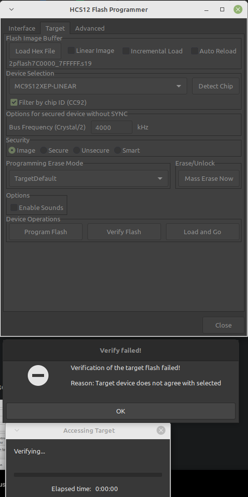

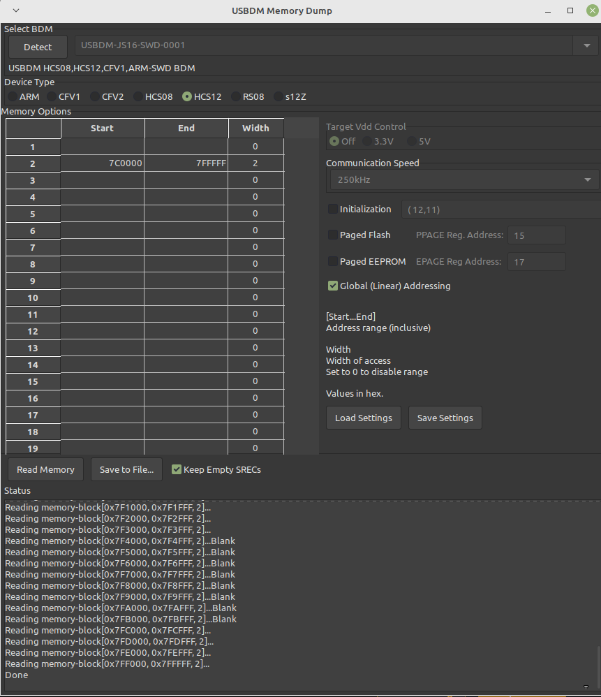

Thank you. I managed to now get the memdump working successfully after updating the program with your configuration modified for 768k flash. I have saved with memdump only a section 7C0000 to 7FFFFF for testing.
However I am having trouble when I select the verify flash button with the HC12 programmer as shown in the picture. The picture below shows the memdump setting and status after reading.
I thought maybe the flash had been copied wrong but comparing rereads show the data to be the same.
So I wondered what might wrong to cause the verify failed message?
