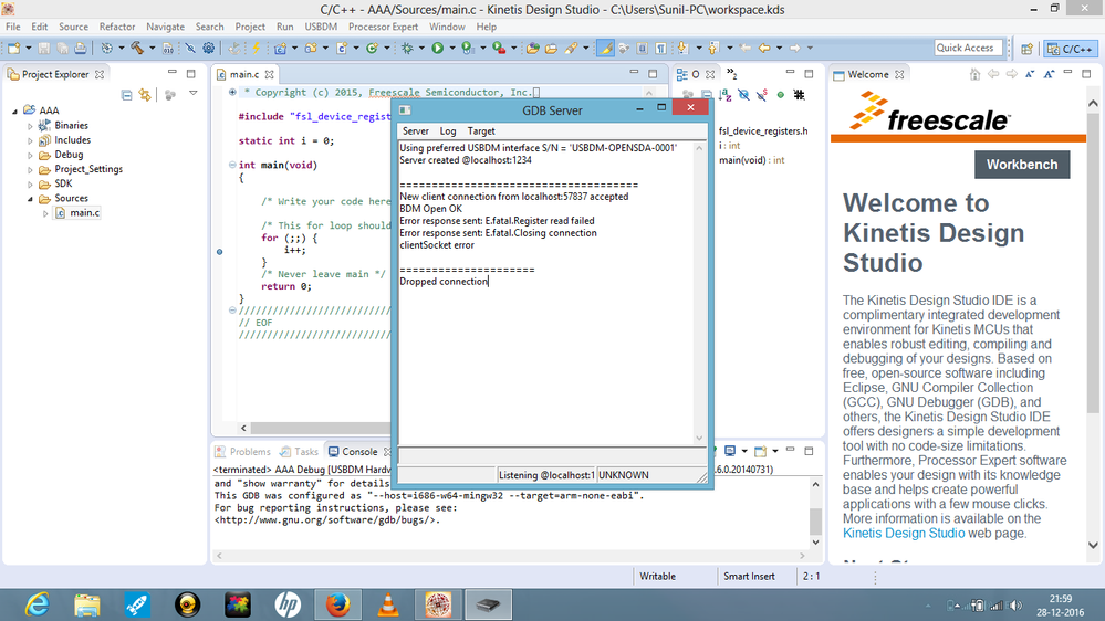

hello guys i am trying to debug kl27 controller from usbdm, when i tried to debug this is giving error like this
Tools : KDS 3.0
USBDM 4_12_1_140
FRDM KL26
Can anyone help me out of this?

I suspect the interface is losing the connection with the target immediately after programming.  This usually indicates some serious problem with the program being executed e.g. clock or watchdog miss-configuration or similar that occurs before main is reached.  The bootloader on the KL27 can also cause problems if it is not disabled in the project.

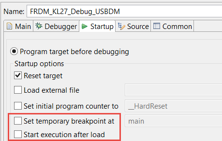

It may be useful to change the launch configuration to not execute the program after loading:

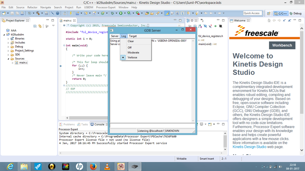

  • After the first failed launch  change the log option on the GDB server to log->verbose to see if it gives any more useful information.

  • Start the GDB server manually from the start menu and turn on logging as described.  Please post a screen grab of the result.
