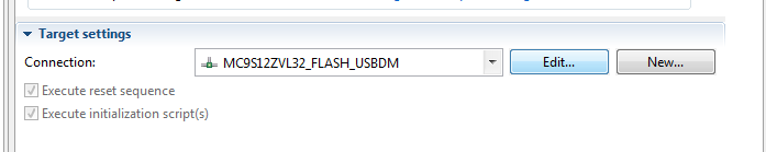

I'm creating project with MC9S12ZVL32 and USBDM connection (C, Double optimized, Large memory model, no Processor expert).
Then I'm flashing generated project into MCU with Run -> Run:

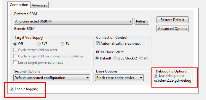

If you want to do more testing please try the following:
  • Enable debugging in the USBDM launch configuration
  • (select edit...)
  • Enable the debugging options:
  • Try programming again.
  • Post the log files from the usbdm directory: %appdata%/usbdm
  • This might give some idea what is going wrong.
