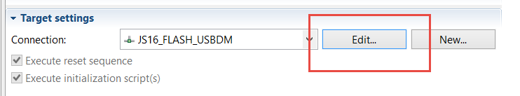

pgo
Senior Contributor V
Hi Dietmar,
I'm sorry I missed your earlier post.
The security region of the flash is treated differently by the programmer.
Have a look at the advanced tab in the stand-alone programmer if you wish to manually set these values.
Alternatively, choose "Image" in the target tab to program as regular Flash.
In Codewarrior these options are controlled by the launch configuration.
USBDM verifies the flash against these modified values.  It does not ignore the differences.
USBDM does not support calculating flash checksums so this would have to be done in some other fashion.
