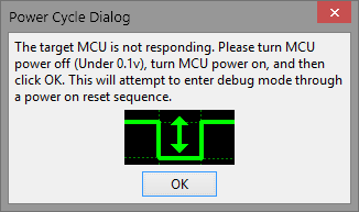

This is the error I get:

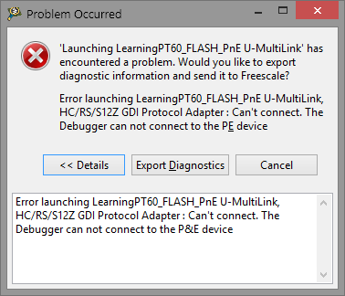

After this point, I can see, with an oscilloscope, that BKGD pin of the MCU is held LOW, while RESET pin HIGH. I cannot turn the MCU off, as I am using the development board. I press on the reset button populated on the board, then press OK. But these things does not help. Then I get this error:

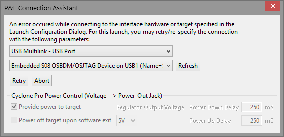

Clicking on Retry does not help. After clicking on Abort, I see this error message:
What is this problem caused by? How can I solve this?

you need to power cycle the CPU (not necessarily the board). To my knowledge the tower board has a jumper to isolote the power from the CPU (for power measurement). Identify that jumper on your board using the schematic, and use that jumper to power cycle the CPU.
I hope this helps.
