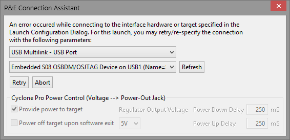

This is the error I get:

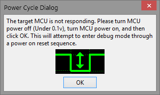

After this point, I can see, with an oscilloscope, that BKGD pin of the MCU is held LOW, while RESET pin HIGH. I cannot turn the MCU off, as I am using the development board. I press on the reset button populated on the board, then press OK. But these things does not help. Then I get this error:

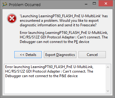

Clicking on Retry does not help. After clicking on Abort, I see this error message:

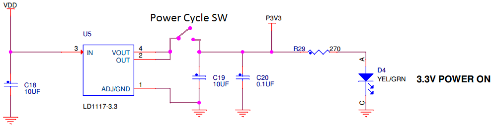

I have solved the problem by Erich's help. The TWR-S08DC-PT60 (700-27325 rev B) board didn't include a jumper that would let me do a power cycle the CPU. I was trying shorting the output of U5 to ground, but that was not a reliable solution and did not work most of the time. So, I have de-soldered U5, which is the 3.3V LDO, then added a switch. It now works, most of the time, since I can power cycle the CPU.Here is my modified schematic:

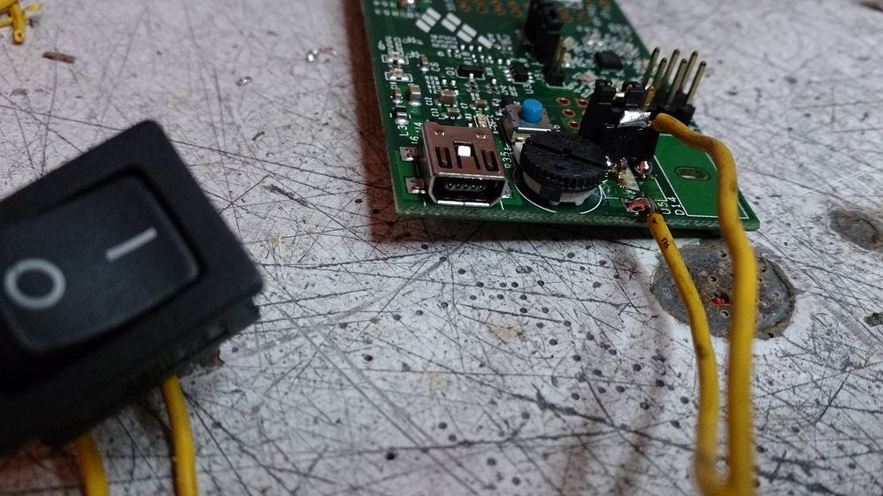

And here is my dirty modification:
