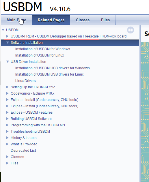

Hello Saw Eddie,
Yes, USBDM support this chip.
You need install USBDM software and driver , refer to this thread :
USBDM: Software Installation
And if you use IDE, for example CWv5.2, please choose it when install USBDM software.
Hope it helps
TIC
