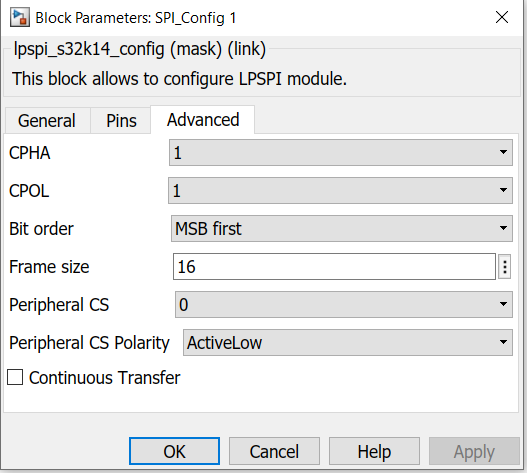

Yes, you can send 16bit messages through SPI - select the Frame size to be 16 bits and use a data store memory with dimension minimum 2 uint8s.
The transfer block sets the transfer width according to its input.
Note: the width of the data memory store should be multiple of 2 (because you've set 2bytes as the frame size).
I've attached a simple example here. Hope this helps.

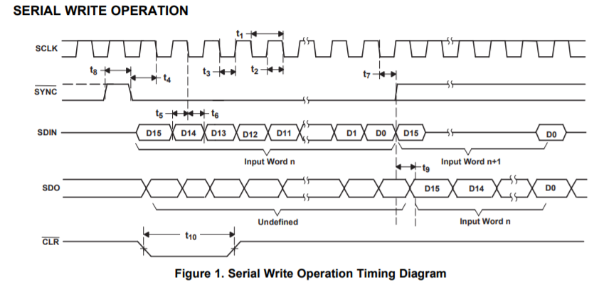

I appreciate your model and help, unfortunately I could not get it working still only using C code. The following is the SPI timing specs;

In Simulink I have it set up as follows with the memory block using uint8(2);
I believe these should be correct, I have tried various different configurations with the test file to get this to work on simulink with no luck.
