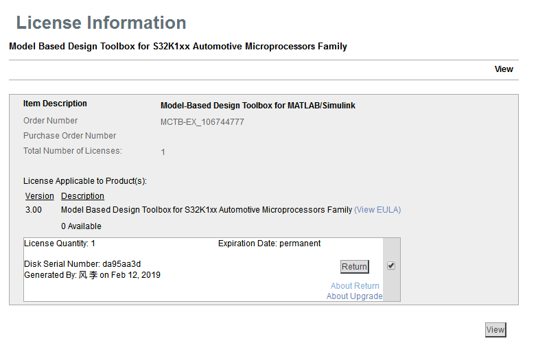

I have just installed MBDToolbox_S32K1xx_v3.0.0_20171016 on my computer. And I got a lincense.bat from this page.

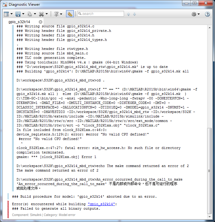

 But while I build gpio_s32k14.mdl there is something wrong .pastedImage_3.png.
I also Installed TDM-GCC V5.1 and creat environment variables like this.
How to solve this error, did anyone have suggestions ?

the toolchain  is error,  TDM-GCC V5.1 is for windows x86/x64 C Compile, Windows API libraries, not for S32K。

You need a head file for compile this project successfully. You can ask them for this file for your projects.

Do you have any particular reasons for installing the version 3.0.0 and not the latest one https://community.nxp.com/docs/DOC-341052  ?

Hi Daniel,
Thanks for your attention.
Because our office is using this version of MBD and using the same version of MBD makes the project better versatile on different computers.
