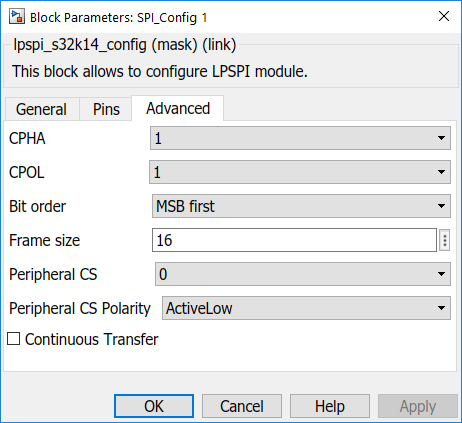

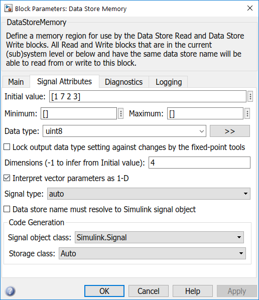

constantinrazva
Hello [email protected]‌,
Yes, you can send 16bit messages through SPI - select the Frame size to be 16 bits and use a data store memory with dimension minimum 2 uint8s.
The transfer block sets the transfer width according to its input.
Note: the width of the data memory store should be multiple of 2 (because you've set 2bytes as the frame size).
I've attached a simple example here. Hope this helps.

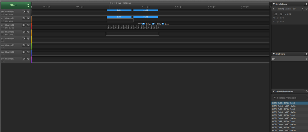

fernando_barrio
Hi constantinrazvan.chivu‌,
I appreciate your model and help, unfortunately I could not get it working still only using C code. The following is the SPI timing specs;
And in C the configuration that worked was as follows (it was tested with both 8 and 16 bits);
In Simulink I have it set up as follows with the memory block using uint8(2);
I believe these should be correct, I have tried various different configurations with the test file to get this to work on simulink with no luck.
Please let me know if you have any other suggestions.
Thank you,
Fernando
