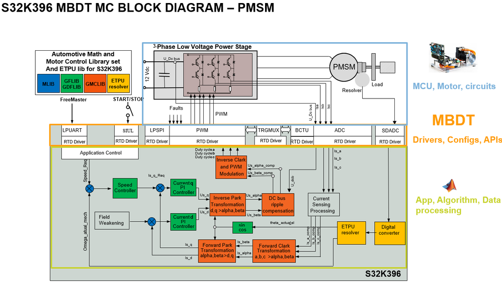

For more details on how this can be achieved, the following diagram is introduced, mapping the PMSM algorithm on top of the existing hardware for the S32K396 MCU. The App, Algorithm, Data processing section can be implemented using Simulink libraries blocks, AMMCLib blocks and Simulink custom code functionalities to include eTPU drivers that address this co-processor access and control. The MBDT section is covered by the blocks provided by the toolbox, ensuring hardware access to the peripherals implied in such applications, while the MCU, Motor, circuits refers to the hardware elements used for the design.
The following picture presents the application mapping of the software and hardware used to develop PMSM Motor Control on S32K396:
Figure 2.1 Application mapping of software and hardware used to develop PMSM Motor Control on S32K396

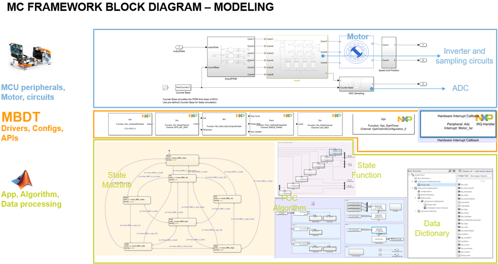

For an overview of the elements necessary for modeling such a diagram inside a Simulink model, the following picture is introduced, showcasing the software components and functionalities that can be used inside this scenario, which will be furtherly detailed in the following sections.
Figure 2.2 Software Components for modeling the PMSM Motor Control on S32K396

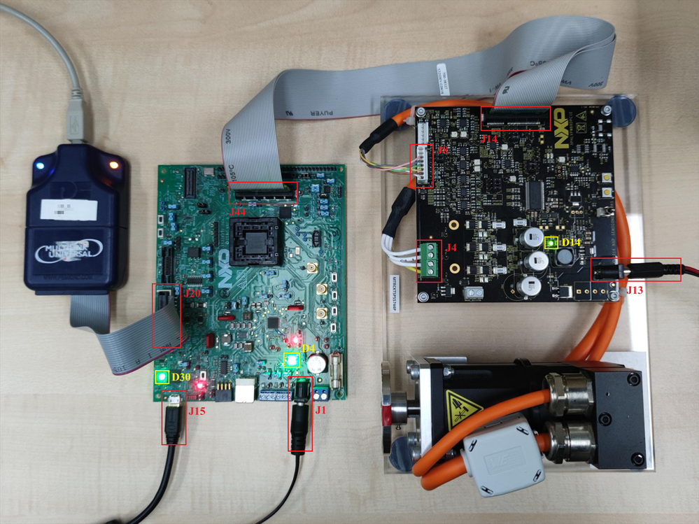

The central controller EVB board runs the control algorithm, and the pre-driver drives the motor. Connect the hardware devices with the following steps:
Figure 2.3.1 Hardware Setup
  1. Connect the PMSM’s three-phase winding to J4 on the pre-driver and connect the resolver signal to J8 on the pre-driver.
  2. Connect motor control signals from J14 on the pre-driver to J44 on the EVB board.
  3. Connect the debugger between JTAG J20 and the computer.
  4. Connect the USB cable between J15 and the computer, then the EVB LED D30 will be solid green.
  5. Plug in the 12V power supply port J1 on the EVB board, then the EVB LED D4 will be solid green.
  6. Plug in the 24V driver power on port J13 of the pre-driver, and then the pre-driver LED D14 will be solid yellow.

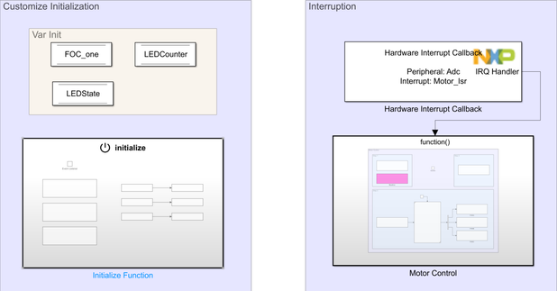

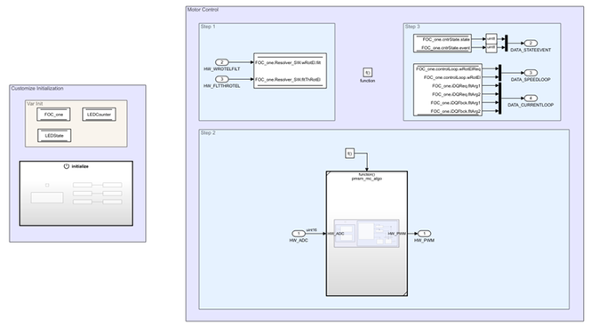

In the following figure, an overview of the main Simulink model is presented. The motor control application model has the following structure: Initialization and Interrupt.
Figure 3.1 Simulink Application Top Model
  • Var Init contains the variables used by the model and can be visualized in FreeMASTER.
  • Initialize subsystem contains the FreeMASTER configuration, state machine and control mode initialization, and BCTU hardware trigger enablement. This subsystem is executed only once, at the beginning of the application.

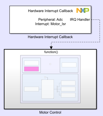

  • Hardware Interrupt Callback calls the motor control block to run. This block delivered by the MBDT, allows the implementation of specific actions inside a callback function which is executed when an interrupt occurs on the configured peripheral instance, at a specific event. Callbacks are associated with specific events inside the configuration project used with the model, which ensures the on-board configuration of the peripherals, pins, and clocks.

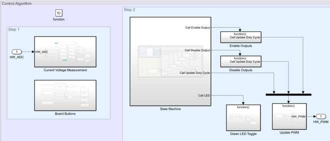

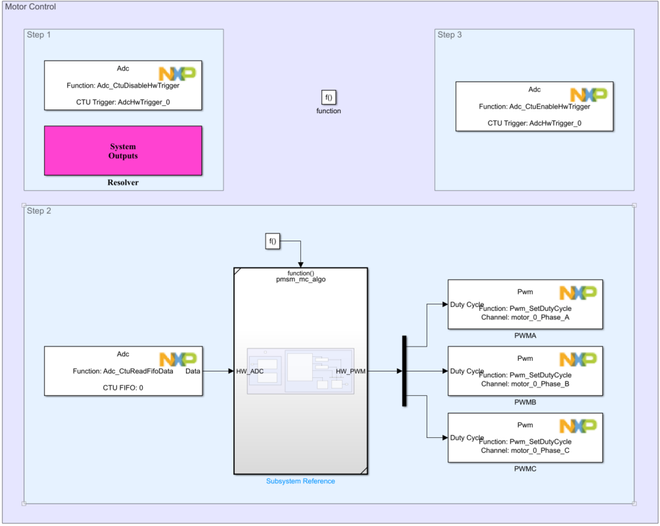

  • Motor Control function-call subsystem runs every time an ADC interrupt occurs.
Inside the Motor Control subsystem, as illustrated below, the ADC hardware trigger is disabled (Step 1) until the PMSM control algorithm calculation is finished (Step 2), and reenabled at the end of this computation (Step 3). The priority order of the generated code is achieved by setting the “Priority” value, accessible inside the Properties of each Simulink block.
Figure 3.2 Motor Control Subsystem
The pmsm_mc_algo algorithm is a subsystem reference model. It collects the input sensor signals, calculates the PMSM control algorithm, and drives PWMs to generate the output voltage. Following figure shows the main blocks:
  • Current Voltage Measurement reads BCTU FIFO data and calls the following blocks.
  • Board Buttons control the motor with hardware pins on board.
  • State Machine subsystem contains the Stateflow® of the motor control application and each state will call a dedicated function block.
  • Enable Outputs enables the PWM output function.
  • Disable Outputs disables the PWM output function.
  • Green LED Toggle controls a green LED to blink.
  • Update PWM calls the MBDT PWM block to update the duty cycle value.

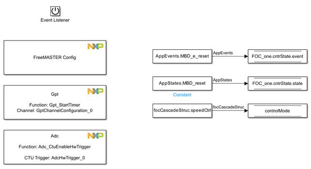

4. Startup initialization
The startup initialization is a subsystem of the initialize function block. It’s used to configure some basic functionality at the start of the application:
  • FreeMASTER Config which configures the UART to communicate with FreeMASTER GUI. FreeMASTER Config block allows the users to configure the FreeMASTER embedded-side software driver, which implements the serial interface between the application and the host PC. It actually inserts the service in the application, and it is the only one mandatory to be added to the Simulink canvas in order to have the FreeMASTER functionality available.
  • Gpt_StartTimer enables one GPT channel for pre-driver MC33937 dead time configuration.
  • Adc_CtuEnableHwTrigger enables the BCTU hardware trigger feature.
  • Set the event and state to reset values and set the default control mode as speed control.

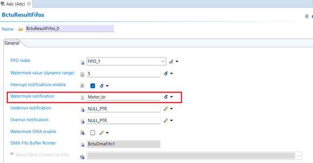

This part describes the configuration and usage of BCTU and ADC modules for analog data capturing. BCTU is triggering parallel ADC conversions for 3-phase current measurements. After all measurements are fulfilled, the BCTU FIFO notification is used to read the stored ADC data and to call the main control loop of the application for further processing.

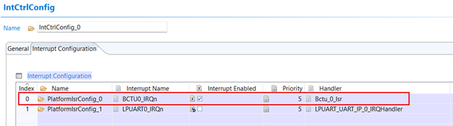

5.1 Interrupt configuration and service
The following picture shows the configuration for the BCTU FIFO notification callback feature. The BCTU FIFO 1 is used to store the ADC results, the watermark value decides when to call the function configured in the notification. Also, enabling the BCTU IRQ in configuration is required.
Figure 5.1.1 BCTU Watermark Notification Configuration
Figure 5.1.2 BCTU Interrupt Enablement
In the Simulink model, the configured notification for BCTU is selected inside the Hardware Interrupt Callback block. This will execute the connected function-call subsystem when the End-of-Conversion interrupt occurs.

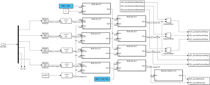

5.2 Measurements of currents and voltage
This section describes the measurement of analog quantities: 3-phase currents and DC bus voltage. BCTU receives the hardware trigger to start the ADC measurements (parallel conversions). Once all results have been stored into the FIFO, the interrupt will call the main control loop. BCTU FIFO notification is used to call the main loop of the motor control, which ensures the sampling is finished before using them. How to get sampled values for processing is presented in this section. The following picture shows the steps and operations to transfer the current and voltage to their real physical values. To acquire the currents and voltage from BCTU FIFO for further processing, the Adc block from MBDT library is used and the Adc_CtuReadFifoData is selected.
Figure 5.2.1 Process converted data to physical values

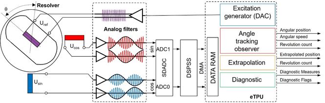

6. eTPU resolver
Software resolver is now widely used in the Inverter application, which can help to save the BOM (Bill of Materials) cost. The eTPU on S32K39 supplies a function to the customer to implement a software resolver via a software package. It uses one eTPU channel to generate a 50% duty-cycle PWM output signal to be passed through an external low-pass filter and used as a resolver excitation signal. In the resolver position sensor, this excitation signal is modulated by the sine and cosine of the actual motor angle. The feedback Sine and Cosine signals are sampled by an SDADC and processed by a followed DSP. The conversion results can be transferred to eTPU DATA RAM by DMA. Then, the eTPU can process the digital samples of resolver output signals and output the position and speed for the FOC. For more details about the eTPU resolver, please refer to AN13038.
Figure 6.1 eTPU Resolver Diagram

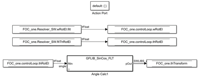

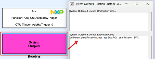

The eTPU Resolver Block is not yet available in MBDT. The System Output block is used to insert custom code for getting resolver data.
The getMotorControlResolver(&mbd_ebt_DW_FOC_one.Resolver_SW) function is used to get resolver data.
Figure 6.1.1 Simulink custom code for eTPU access
The speed and angle are estimated from the Resolver Angle subsystem and are provided to the slow & fast control loops. Finally, the sine and cosine values from the estimated electrical angle are computed.
Figure 6.1.2 Computation of the speed and angle

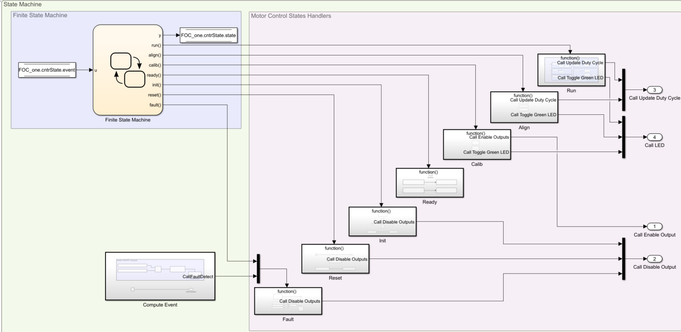

7. State machine
This is a critical part of the motor control application model, each state has a dedicated block to handle the related functions.
Figure 7.1 Motor Control States Implementation

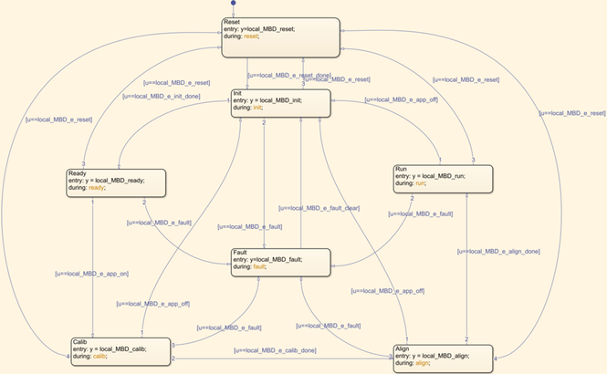

The state machine block controls the workflow of the motor control application, it has been designed using Stateflow.
Figure 7.2 Finite State Machine

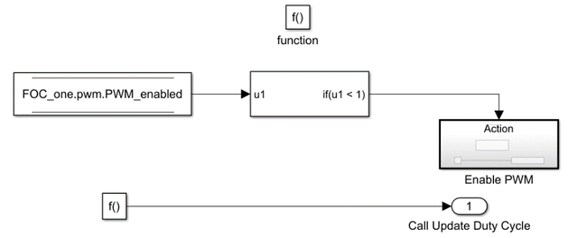

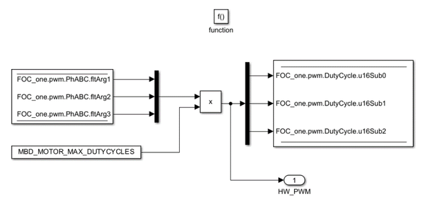

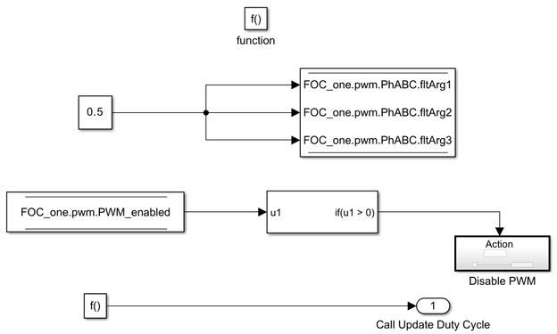

8. PWM control and update
Subsystems Enable Outputs and Disable Outputs control the output of PWM. They are called by the state functions. In the subsystems, the flag PWM_enabled and gate driver output status are changed via the pwm_enable_output or the pwm_disable_output function.
Figure 8.1 Enable Outputs Subsystem
Figure 8.2 Disable Outputs Subsystem

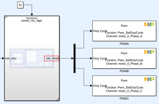

Update PWM subsystem is used to generate the PWM duty cycle value according to the output from the control loop. This value is eventually set for the FlexPWM peripheral to generate PWM voltages to drive the motor. The FlexPWM is configured to generate complementary signals for bridges and is updated synchronously according to a reload signal in the EB project. Here it is only needed to pass the duty cycle values to the Pwm function in the model.
Figure 8.3 PWM Duty Cycle Values Computation
Figure 8.4 PWM Duty Cycle Values Update

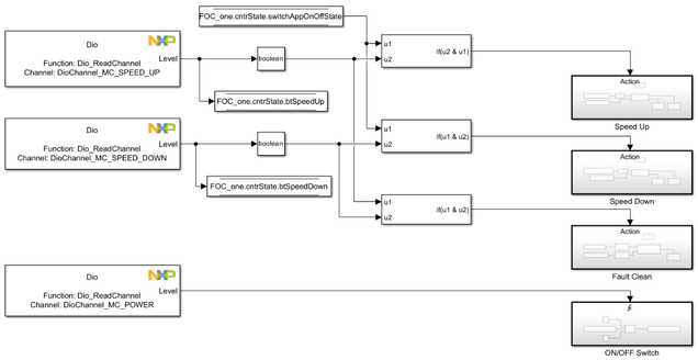

9. Buttons
Buttons are used to control the running of the motor. The algorithm reads the value of the button from the board to change the running state or speed. The Dio block in the MBDT library is used to read the value of I/O. The I/O port of buttons has been configured in the EB project. Two buttons on the board are used to increase or decrease the running speed of the motor. Also, they are used to clear the fault information when pressed together. One button is used to control the start or stop of the motor. The following picture shows the subsystem for the button control logic.
Figure 9.1 Buttons Control Logic

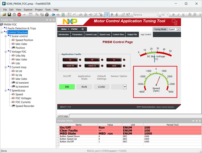

10. FreeMASTER GUI
FreeMASTER is a user-friendly real-time debug monitor and data visualization tool that enables runtime configuration and tuning of embedded software applications. To enable FreeMASTER in this project, the interface needs to be configured first.
MBDT supplies blocks to support FreeMASTER’s configuration. In this project, LPUART_0 is used to transmit data between the GUI and the board. The following figure shows the MCAT GUI, which can be used to observer parameters/variables and also used to control the status of the motor. It can be found in the project folder, under “./mbd/FreeMASTER_control”.
Figure 10.1 MCAT GUI

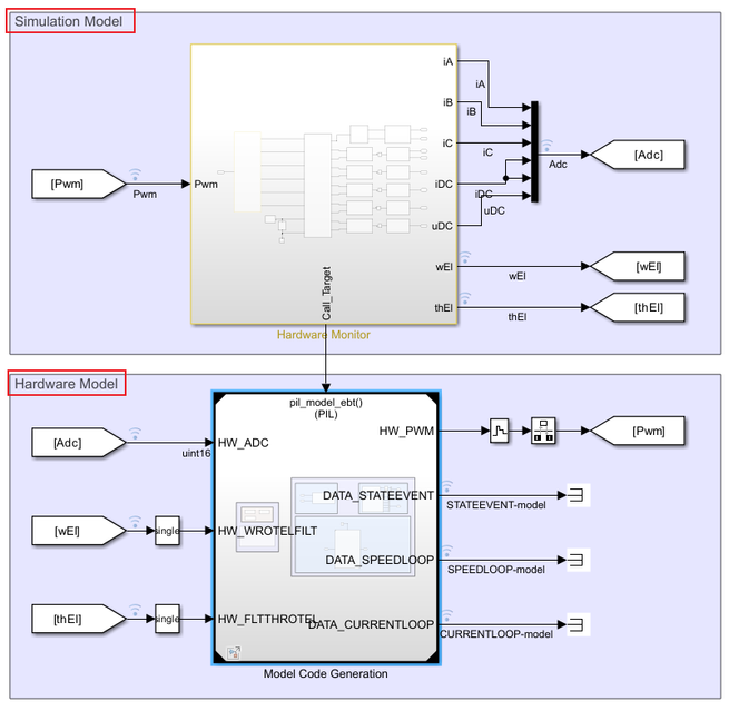

11. PIL model
PIL represents a verification and validation step where the code generated for the developed control algorithm is cross-compiled and deployed on the target hardware, then stimulated with test inputs from the Simulink application executed on the host PC, containing the plant model. The test inputs are sent to the target via Serial Communication. By enabling this simulation mode, users could test the performance of the processor long before having the final hardware design, testing whether the model and the generated code are numerically equivalent, and being able to perform code execution profiling.
Hence, for this motor control design, we have also developed a PIL model (pil_model_ebt) used to verify the model-generated code on the S32K396 microcontroller. The PIL top model contains two parts: Simulation Model and Hardware Model. The Simulation Model contains the model of the real system (pre-driver and PMSM), as depicted inside Section 11.1. The Hardware Model contains the control algorithm which is the same as in the application previously introduced (mbd_ebt.slx). For the hardware Model part, the code will be generated, built and an executable file will be deployed on hardware. Input and output signals processing blocks will generate the necessary test inputs for the code that runs on the hardware controller, as depicted in the screenshot below.
Figure 11.1 PIL Top Model
11.1 PIL Model introduction

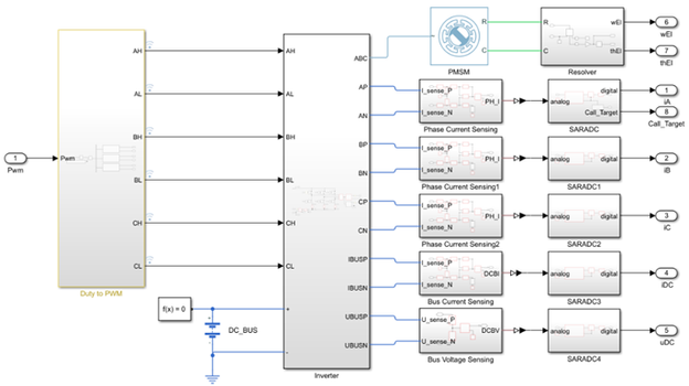

The PIL top model runs the simulation model part inside the Simulink environment and exchanges signal data with the hardware controller through Serial Communication.
11.2 Simulation model
The simulation model simulates the hardware of the pre-driver and PMSM using Simscape™ Electrical™ blocks.
  • Duty to PWM simulates the function of a central aligned FlexPWM with the frequency of 20kHz.
  • Inverter simulates three-phase full-bridge circuit with the same parameters as in MC33937 MOSFETs pre-driver.
  • PMSM is defined with the same parameters as the real motor.
  • Resolver is simplified as an ideal rotational motion sensor.
  • Phase Current Sensing, Bus Current Sensing and Bus Voltage Sensing are built up regarding MC33937 MOSFETs pre-driver.
  • SARADC block samples signal simultaneously with the PWM module and generates a function call after data conversion is completed.
Figure 11.2.1 PIL Host Model
11.3 Hardware model
The hardware model is a referenced model that generates code and deploys it into the microcontroller. It’s called by ADC conversion completion signal.
In the initialization process, it initializes the global variables and drivers. In the normal running process, when a function call comes, the model will calculate the input signal, run the state machine, and generate the output signal in the order defined in subsystem “pmsm_mc_algo”.
Figure 11.3.1 PIL Target Model
