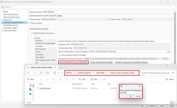

The toolbox delivers default configuration projects, available in both S32 Configuration Tools and EB tresos, covering an initial enablement of the on-board peripherals, pins, and clocks, for all the supported S32K3 derivatives. The desired template, which represents the starting point for enabling the hardware configuration of the application, can be selected via a dropdown widget.
  • Support for creating and using Custom Project Templates
The toolbox provides support to use and create custom project templates. This could be very useful when having a custom board design – offering the possibility to create the configuration for it only once. After it is saved as a custom project template, it can be used for every model that is being developed.
Such custom projects, addressing specific hardware designs are offered inside the current version of the toolbox to integrate the following EVBs:
    • S32K312MINI-EVB
    • MCTPTX1AK324
    • S32K344-WB
    • S32K3-T-BOX
    • S32K396-BGA-DC1
    • MR-CANHUBK344, alongside a set of examples specifically created to target this hardware design and a series of articles (available on NXP Community) demonstrating how to use the toolbox features and functionalities for creating applications for custom boards.

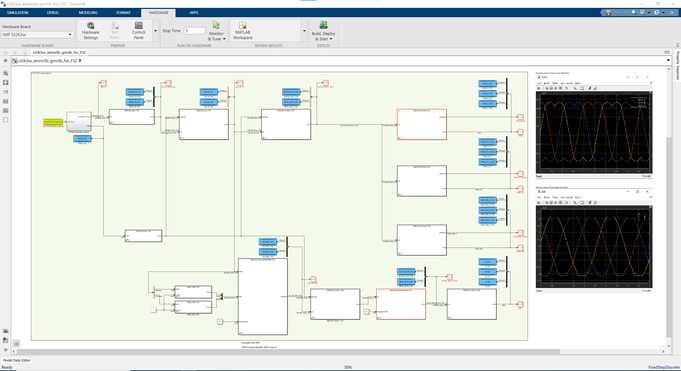

All functions in the Automotive Math and Motor Control Functions Library v1.1.42 are supported as blocks for simulation and embedded target code generation.

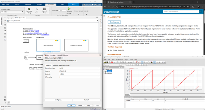

  • FreeMASTER Integration
We provide several Simulink example models and associated FreeMASTER projects to demonstrate how our toolbox interacts with the real-time data visualization tool and how it can be used for tuning embedded software applications.

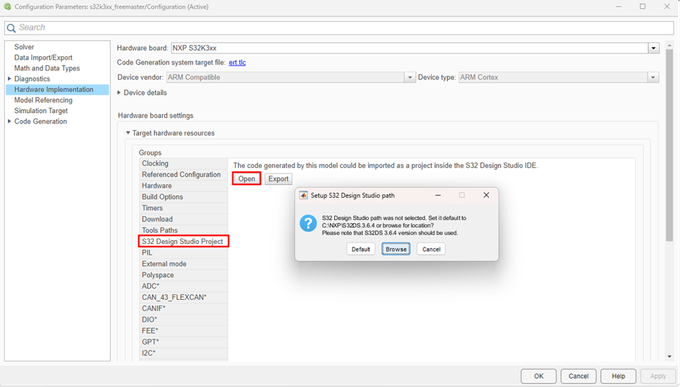

  • S32 Design Studio integration
We provide the feature of importing the code generated from a Simulink model inside the S32 Design Studio IDE. This functionality can be useful if the model needs to be integrated into an already existing project or for debug purposes.
  • Simulation modes
We provide support for the following simulation modes (each of them being useful for validation and verification):

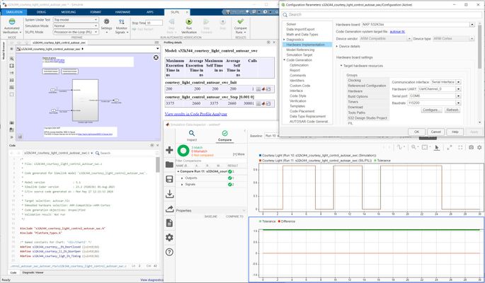

    • Software-in-Loop (SIL)
    • Processor-in-Loop (PIL) including AUTOSAR SW-C deployment
    • External mode
  • Motor Control Applications

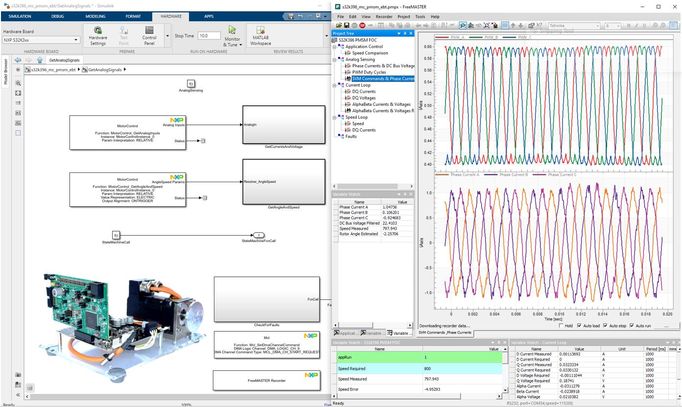

The toolbox provides examples for 1-shunt and 2-shunt PMSM and BLDC motor control applications, supporting both S32 Configuration Tools and EB  tresos. Each of the examples provides a detailed description of the hardware setup and an associated FreeMASTER project which can be used for control and data visualization. The toolbox also demonstrates the integration of the Motor Control Blockset in developing such applications.
For demonstrating the S32K3 eTPU Software integration, we have included a PMSM application where the FOC algorithm runs on the main CPU of the S32K396 MCU, while the analog sensing, software resolver, and PWM signals generation are offloaded to the eTPU co-processor.
The motor control applications were developed and validated on the MCSPTE1AK344 and MCSPTR2AK396 Motor Control kits.
