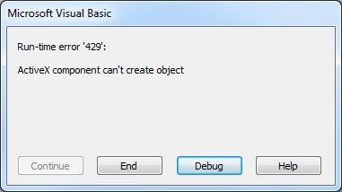

I figured using the ActiveX controls via VBA/ Excel would be an optimal way to do what I'm trying to do (i.e. get value -> put into spreadsheet for log), but the included example won't even compile. Looking at the User Manual, it appears they're even referencing an old version of FreeMASTER (v1.3), so it's not clear how frequently anyone even looks at this stuff.
I'm currently seeing the following error on the line for "Set fmstr = New McbPcm" - indicating it can't initialize the ActiveX object (and yes, the Project has properly defined reference per the manual). Are there any guidelines/ help articles on how to create the objects and manipulate them for different communication methods (like CAN)? The User Manual goes through the different *methods*, but is pretty short on the recommended usage.

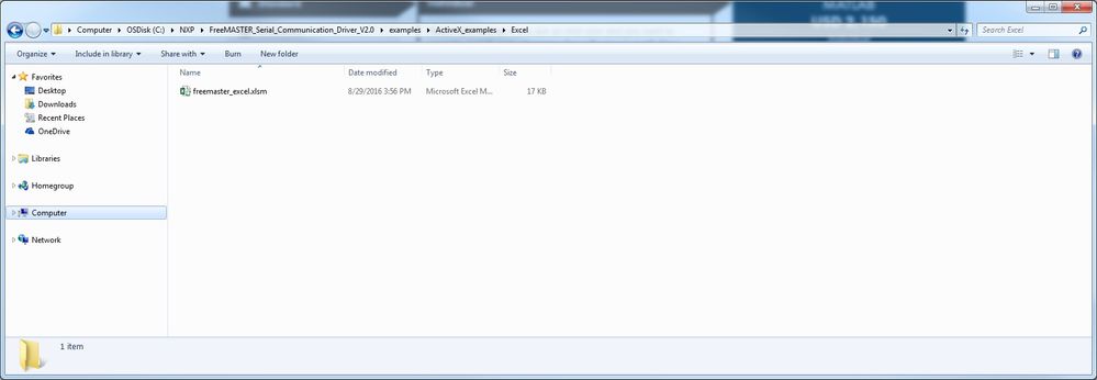

Then, I open the excel example from this location (c:\NXP\FreeMASTER_Serial_Communication_Driver_V2.0\examples\ActiveX_examples\Excel):

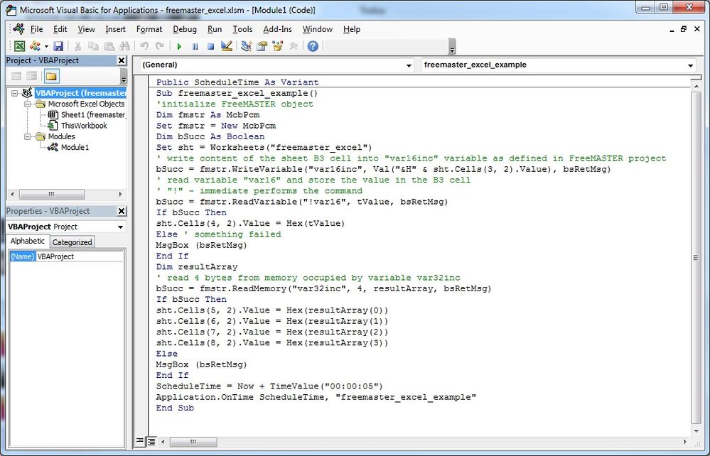

Opening the Excel spreadsheet, I obviously hit "enable macros", and then go into VBA to look at the example (identical to the user manual):
From here, I hit "Debug -> Compile VBA Project", where I'm given the ActiveX error from before:

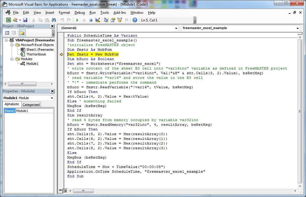

Hitting "Debug" on this dialog points me to this line, indicating it can't create an "McbPcm" instance

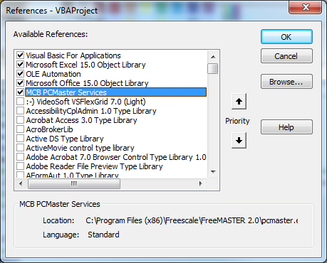

Going into "Tools -> References" Verifies that the proper services are in the example:

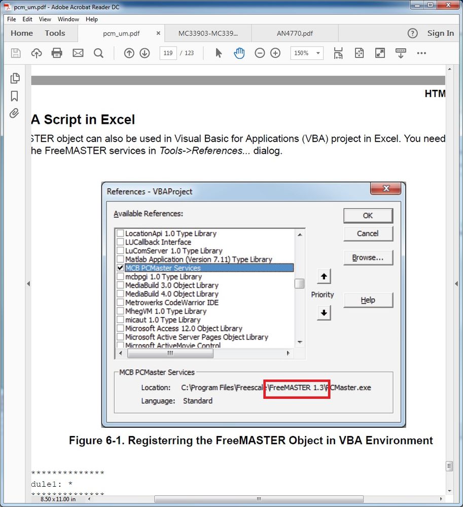

The FreeMASTER 2.0 Manual shows version 1.3 being used in the Excel example here:
Please let me know why the example can't create the object - I should be able to tweak the rest.
