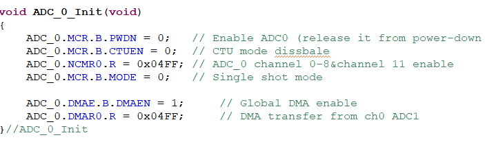

Thank you for help.Now there is a new question。Is there  any problem to  achieve the ADC0 channel0-8 & channel11 by DMA through the way below?
569d941b58f79175714555978bef2db.png6b30066c8f9807d54b58d41436bc695.png78d10a41604f1f53b6ed085d4134395.png

petervlna
I am quite confused.
what to achieve? Start of ADC? ADC result transfer? or?
