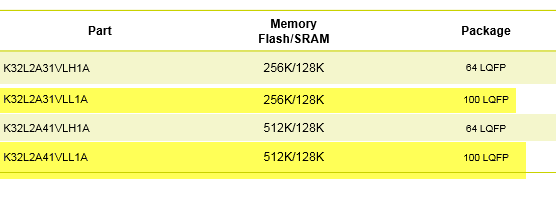

    The K32L2A31VLL1A related circuit can refer to the  FRDM-K32L2A4S schematic directly.
    FRDM-K32L2A4S on board chip is K32L2A41VLL1A, your chip is K32L2A31VLL1A , even the package is the same, just the Flash and SRAM difference:

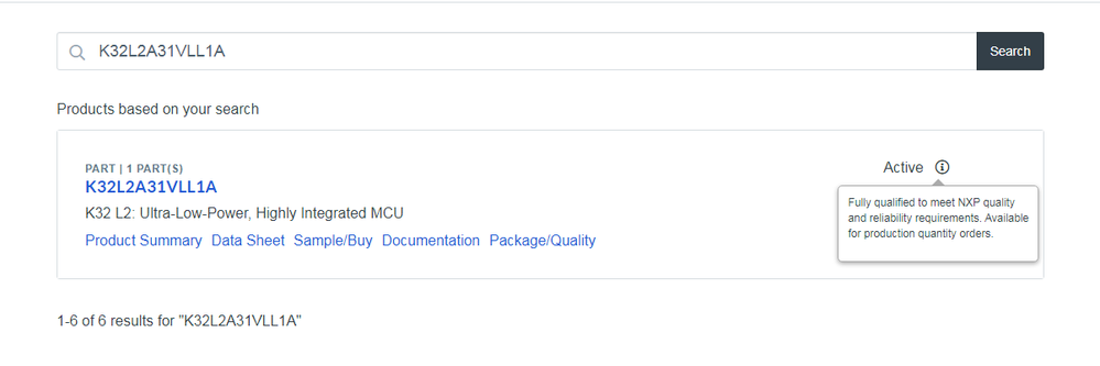

About the samples, you can apply it from the nxp.com:
 You can find it is active now.

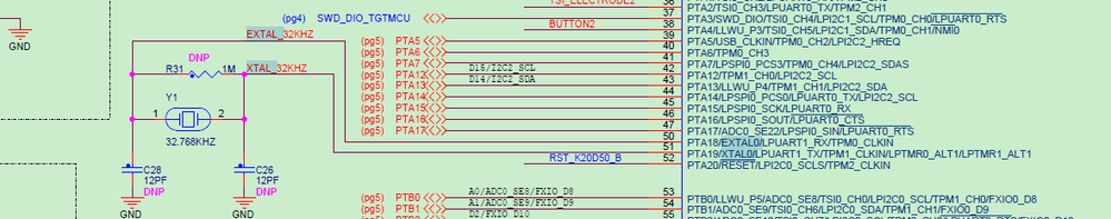

About the board, you can refer to the FRDM-K32L2A4S, you can use FRDM-K32L2A4S directly or change the on board chip to K32L2A31VLL1A.
About the peripheral hardware, the same as FRDM-K32L2A4S, you can refer to it directly.
1. SPI (1 no.)
2. I2C (1 no.)
3. UART(1 no.)
4. JTAG Debug
5. GPIOs, (30/40 numbers)
  Check the fanout J1,J2, J3,J4 refer to your own design.
6. Clock, Reset, etc...
 clock,
reset pin, 4.7K to 10K pullup, and 0.1uf capacitor to ground.
More details, check the FRDM schematic which I give you, you totally can refer to it.

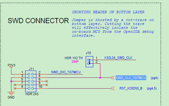

  K32L2A31VLL1A can refer to the FRDM-K32L2A4S:
FRDM-K32L2A4S Platform | Freedom Development Board | K32 L MCUs | NXP
  But, it seems the design file still not put in the nxp website.
  Anyway, I will help you to check it with our internal side,apply for upload the related schematic and the design file to the website.
  Here I share with you one K32L2A4 schematic at first.
