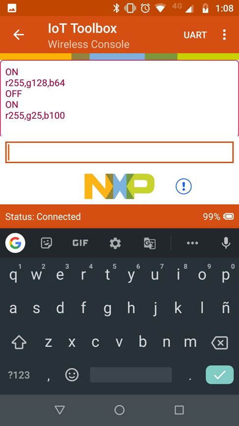

  13. Send "ON" to activate the PWM functionality.

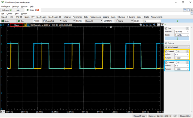

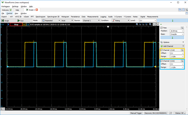

  14. Send "r255,g128,b64" to set the PWM pins to 100%, 50%, 25%.
  15. This signal must be displayed at 100Hz on the oscilloscope.

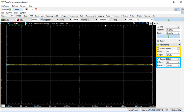

  16. Send "OFF" to deactivate the PWM functionality.

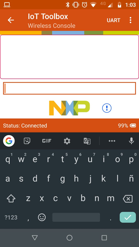

1. After the QN9080 is flashed and in Advertising mode, we have to connect our Central device, Which in this case is an Android phone. In or Teraterm we should be able to see this message:
2. Then, we get the Connected status from our devices and we should be able to send the ON command and the RGB values, Teraterm indicates the integer values and the string received.
3. When we send the OFF command the PWM signals should be 0 V.
4. Here is another example:
