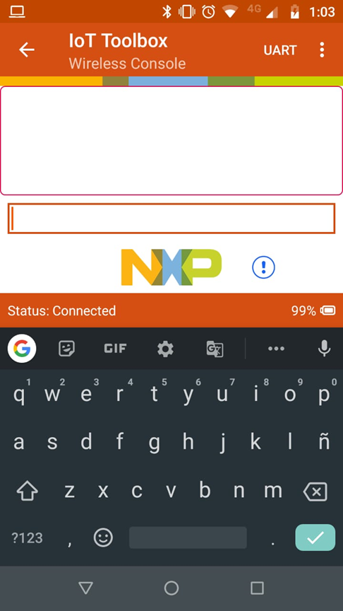

    1. If an Android phone is used we need to have the IoT Toolbox application installed and select the Wireless UART example and connect to the Peripheral board using the interface.

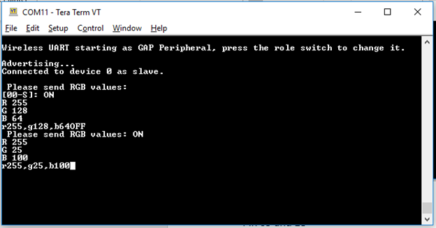

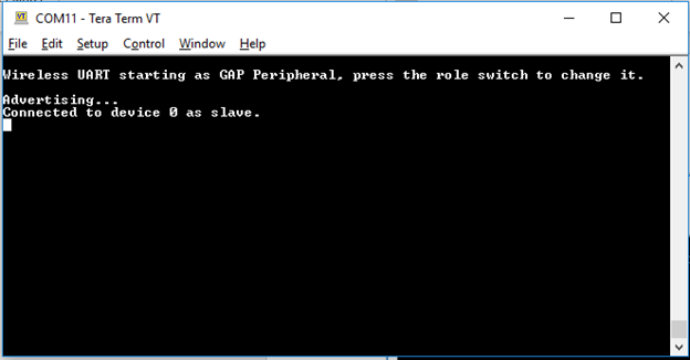

1. After the QN9080 is flashed and in Advertising mode, we have to connect our Central device, Which in this case is an Android phone. In or Teraterm we should be able to see this message:
2. Then, we get the Connected status from our devices and we should be able to send the ON command and the RGB values, Teraterm indicates the integer values and the string received.
3. When we send the OFF command the PWM signals should be 0 V.
4. Here is another example:
