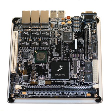

The very rapid adoption of digital media such as downloadable music, video games, and movies has created a strong demand for converged network platforms to distribute media content throughout the home. Consumers need a unified platform that connects all digital networked devices within the home and provides content and services management from anywhere in the world.
The MPC8349E-mITX is a turnkey hardware/ software reference platform ideal as a "location-free control access" residential gateway solution. This reference platform is based on the MPC8349E PowerQUICC® II™ Pro processor, containing a Power Architecture® core and HipServ™ software platform from Axentra, a leading provider of personal digital content and services software platform for the Digital Home.

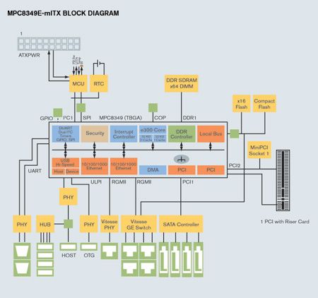

The MPC8349E-mITX integrates the enhanced e300 Power Architecture core and advanced features such as DDR memory, dual PCI, Gigabit Ethernet, and high-speed USB controllers. The platform supports dual 10/100/1000 Mbit/s Ethernet controllers, dual 32-bit/single 64-bit PCI controllers, integrated security engines, USB 2.0 host and devices controllers, 4-channel DMA, DUART, serial peripherals, general-purpose I/O and system timers. The high level of integration in the MPC8349E helps lower system costs, improves performance, and simplifies board design. The MPC8349E also integrates a hardware encryption block that supports different algorithms for high-performance data authentication as required for secure communications in the residential market. It supports DES, 3DES, MD-5, SHA-1, AES, PKEU, RNG, and RC-4 encryption algorithms in hardware.
In addition to the highly integrated MPC8349E processor, the reference platform leverages external components to support these additional features:
  • 5-port Gigabit Ethernet switch
  • Four high-speed USB ports
  • Four Serial ATA ports
  • PCI slot
  • MiniPCI slot
  • Compact FLASH memory slot
