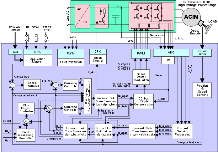

This reference design demonstrates a vector control technique of a 3-phase AC induction motor with a position encoder coupled to the motor shaft.
The algorithm runs on Our 56F80X or 56F83XX Digital Signal Controller as the dedicated motor control device
It can be adapted to NXP® 56F81XX Digital Signal Controllers
The speed closed loop ACIM drive is implemented
The system is targeted for applications in both industrial and appliance fields (e.g. washing machines, dishwashers, industrial drives, machine tools, variable speed drives, elevators etc.)
Features
  • Vector control technique used for ACIM control
  • Targeted for 56F80X, 56F83XX, and 56F81XX Digital Signal Controllers
  • Running on a 3-phase AC induction motor control development platform at variable line voltage 115/230V AC
  • Encoder used for a speed calculation
  • Control technique incorporates:
    • Speed control loop with inner q axis stator current loop
    • Rotor flux control loop with inner d axis stator current loop
    • Field-weakening technique
    • Stator phase currents measurement method
    • DC-Bus ripple elimination
  • Motor and generator mode
  • DC-Bus brake
  • Overvoltage, undervoltage, overcurrent and overheating fault protection
  • FreeMASTER software control interface and monitor
Block Diagram
