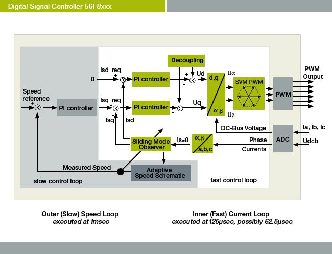

  • 3-phase sensorless PMSM speed vector control (FOC)
  • Sliding mode observer with adaptive velocity estimation
  • Based on NXP® MC56F8013 (resp. 56F8346) controller
  • Running on a 3-phase high voltage (230/115V) power stage
  • FreeMASTER software control interface and monitor
