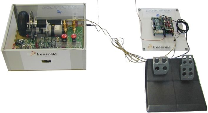

Overview
The FlexRay Brake-By-Wire reference design shows FlexRay capabilities such as high communication speed and channel fault detection.
  • It uses the NXP® MC9S12XDP512 MCU for the pedal node and MC56F8346 DSC for the brake/wheel node; FlexRay connectivity of both nodes is based on the MFR4200 FlexRay communication controller
  • The braking caliper is controlled by PMSM using Vector Control technique while the spinning wheel representing a real tire is powered by a BLDC motor
  • The boards of the 2 engines are interconnected by a CAN bus
  • Uses FlexRay baud rate of 10Mb/s per channel but both channels carry the same data, which enables demonstration of the FlexRay channel fault detection feature
