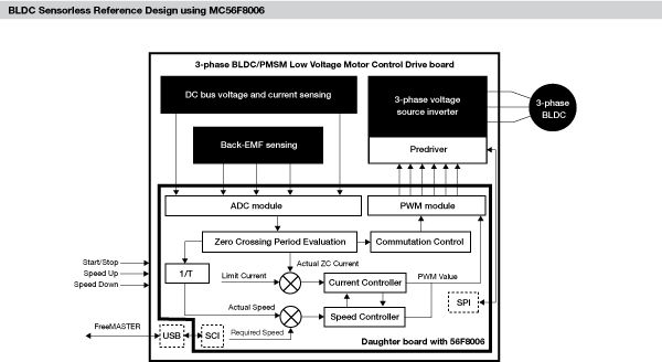

Overview
This reference design describes a 3-phase brushless DC motor (BLDC) drive that uses the NXP® MC56F8006 Digital Signal Controller (DSC) for dedicated motor control devices.
  • Closed-loop speed/current-controlled BLDC drive, with no need for position or speed sensors.
  • Low-voltage power stages used by the application are designed for 24 VDC line voltage.
  • A reference manual provides a detailed description of the application, including hardware and software design.
  • Hardware schematics, PCB Gerber files and full software listings are also provided.
  • Ideal for applications such as compressors, dishwasher pump drives, washing machines, fans and industrial motor control.
Features
  • Sensorless control of BLDC
  • Control technique incorporates:
    • Speed closed-loop control with automatic current limitation
    • Rotation in both directions
    • Start from any motor position with rotor alignment
    • 4-quadrant operation
    • Multisampling method of back-EMF
  • Wide speed range
  • FreeMaster control interface
  • Fault protection for overcurrent, overvoltage, overload and start-up fail
Block Diagram
