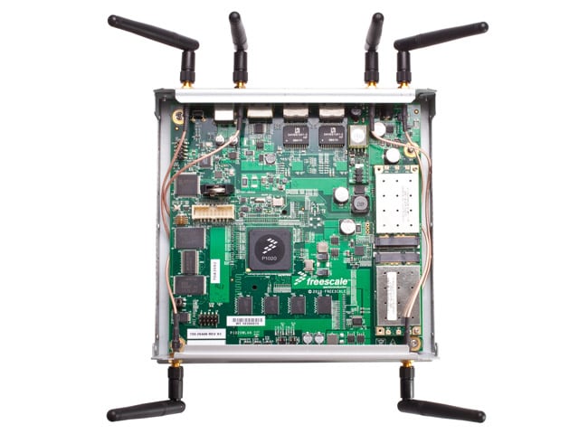

The QorIQ® P1020EWLAN access point/router is a complete production-ready, bill of materials optimized solution that can support single- or dual-radio 802.11 a/b/g/n/ac devices through MiniPCI or Mini PCI Express® interfaces.
  • IEEE® 802.11N WLAN radios capable of supporting wireless data rates up to 300 Mbps per and the P1020 communication processor is ideal to maximize performance while meeting power and cost budgets
  • Can be powered over a single Ethernet cable in 3 x 3 MIMO mode using a single 802.3af Power over Ethernet (PoE) link
  • Provides complete data and control path processing needs for multiple radio solutions and excellent throughput with best-in-class performance/watt

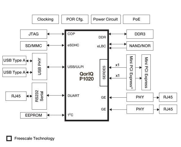

  • P1020 in 45nm SOI operating at 533-800MHz dual core e500 processor with 256KB L2 cache with ECC
  • 256MB to 512MB DDR3 SDRAM
  • 4 FXS ports
  • 1 FXO port
  • 1 GbE RGMII port
  • 1 GbE SGMII port
  • 1 GbE port connected to RGMII 5-port switch
  • 2 mini-USB 2.0 ports
  • 1 mini-PCI Express connector
  • 1 PCI Express
