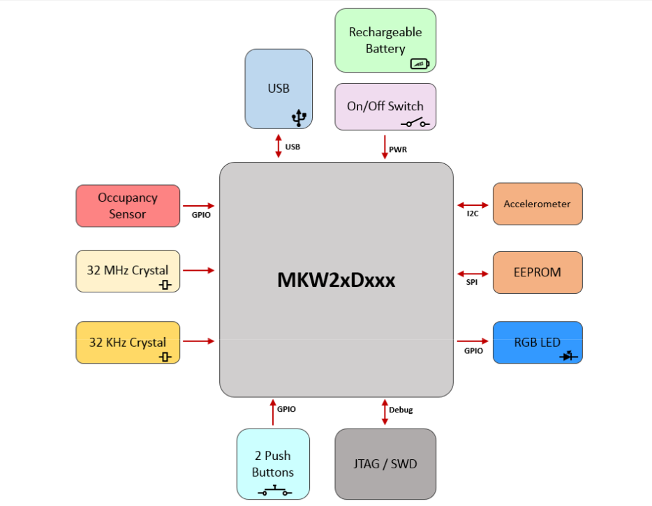

Overview
The Occupancy Sensor Node reference design is a compact form factor, open source design. It enables low power nodes based on IEEE 802.15.4 protocols such as Thread and ZigBee to communicate data to a wireless sensor network. NXP supplements the Kinetis KW2xD with tools and software that include hardware evaluation and development boards, software development IDE and demo applications and drivers.
Features
  • MKW24D512 802.15.4 Kinetis MCU
  • Full IEEE 802.15.4 compliant wireless node for Thread network
  • Integrated PCB meander horizontal antenna
  • 2 Interrupt push button switches (LLWU)
  • 1 FXOS87000CQ Combo sensor
  • 1 Coin cell battery holder
  • 1 EEPROM
  • 1 Battery charger
Block Diagram
