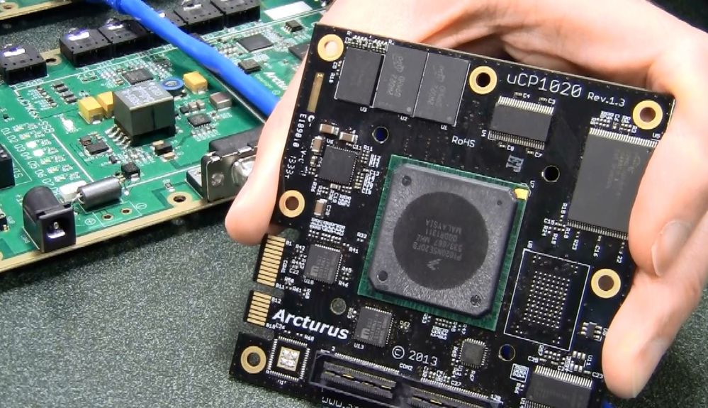

uCP1020 IoT Gateway System-On-Module Hardware

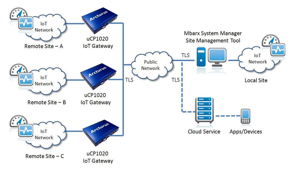

Demo Diagram(s)
IoT Physical Components
Gateways
Edge Devices
  • SOC:2x 10/100/1000BaseT networking supported natively by the P1020 processor and on board network PHYs
  • Modules:Various PCIe and miniPCIe based connectivity options (see wireless below)
  • Software:Linux

  • Software/Services: Arcturus Mbarx IoT Gateway middleware is fully compatible with Mbarx IoT end-nodes such as uCMK60 based on K60, K64.
  • Mbarx IoT protocol supports TCP/IP sockets with TLS security and simple character driven protocol
  • Mbarx IoT Gateway middleware supports remote-site aggregation, secure connectivity and device management proxy.
  • Optional plugs-ins for MQTT, CoAP and other popular IoT/M2M protocols.
Smart Devices/Apps
  • Software: Mbarx-Operations Controller supports cross-platform work-flow driven, operational control using a responsive HTML5 architecture.
  • Mbarx-System Manager site-wide IoT device/node management tool is available for PCs.
