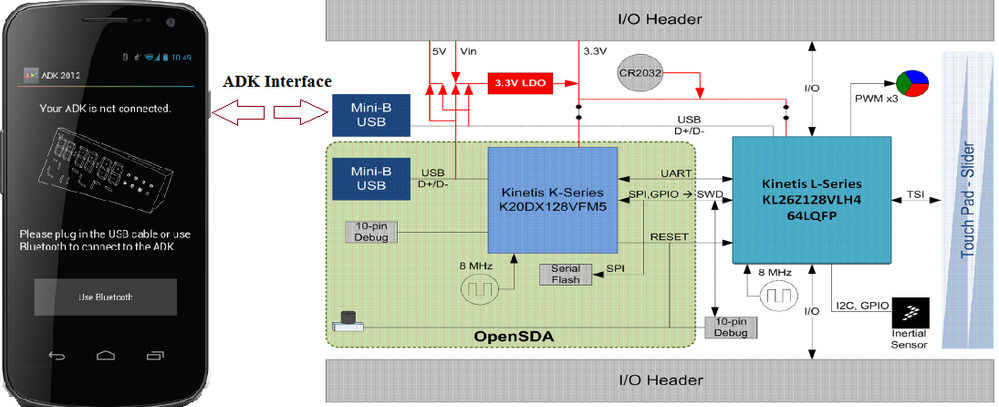

Android Open Accessory support allows external USB hardware (an Android USB accessory) to interact with an Android-powered device in a special accessory mode. When an Android-powered powered device is in accessory mode, the connected accessory acts as the USB host (powers the bus and enumerates devices) and the Android-powered device acts in the USB accessory role.
This ADK library is based on NXP Kinetis Microcontroller KL26, It implements some functions to communicate with android phone.
