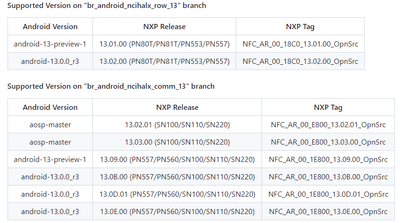

Two branches are provided for the NFC chip of Android 13 version pn557, namely br_ Android_ Ncihalx_ Comm_ 13 br_ Android_ Ncihalx_ Row_ 13. I would like to ask about the differences between these two branches and how to choose which one to use.
661 Views
Ricardo_Zamora
Hope you are doing well. You can find on the README of the GitHub - NXPNFCProject/NFC_NCIHAL_Nfc: NFC_NCIHAL_Nfc the Android Version and NXP release for those branches:
