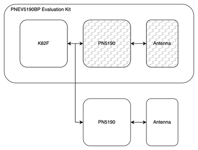

I tested another board, and NfcrdlibEx4_MIFAREClassic example is running correctly. So, I'm guessing that it may be some PN5190 EEPROM data misconfiguration? Is there any command to load/reset EEPROM data to factory defaults?
Meanwhile, I purchased PNEV5190BP and I'm trying these configurations:
abacus_0-1700642617221.pngabacus_0-1700642617221.pngabacus_1-1700642649444.pngabacus_1-1700642649444.png
I'll come back with some results.

I managed to connect my PN5190 to the Evaluation Board (R5 and R7 shorted, R6 open).
First I got this warning, so I updated the FW to r2.F7 through Secure Upgrade.
I loaded default EEPROM data and I'm able to perform some operations, but once I hit "Rf Field On", the  Evaluation Board and the Cockpit application, both become unresponsive. I need to power cycle to recover. Here's the output of Log Monitor:
