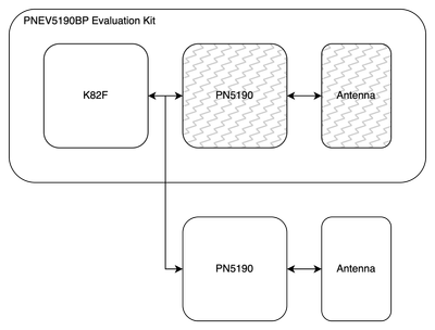

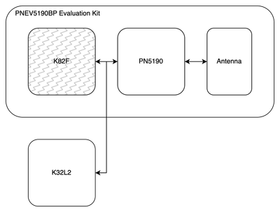

Meanwhile, I purchased PNEV5190BP and I'm trying these configurations:
I'll come back with some results.

abacus
Hi Daniel
I would suggest you pull up the SPI signals on K32 side.
I'll try that, but it does not seem an issue related to K32.
I managed to connect my PN5190 to the Evaluation Board (R5 and R7 shorted, R6 open).
First I got this warning, so I updated the FW to r2.F7 through Secure Upgrade.
I loaded default EEPROM data and I'm able to perform some operations, but once I hit "Rf Field On", the  Evaluation Board and the Cockpit application, both become unresponsive. I need to power cycle to recover. Here's the output of Log Monitor:
