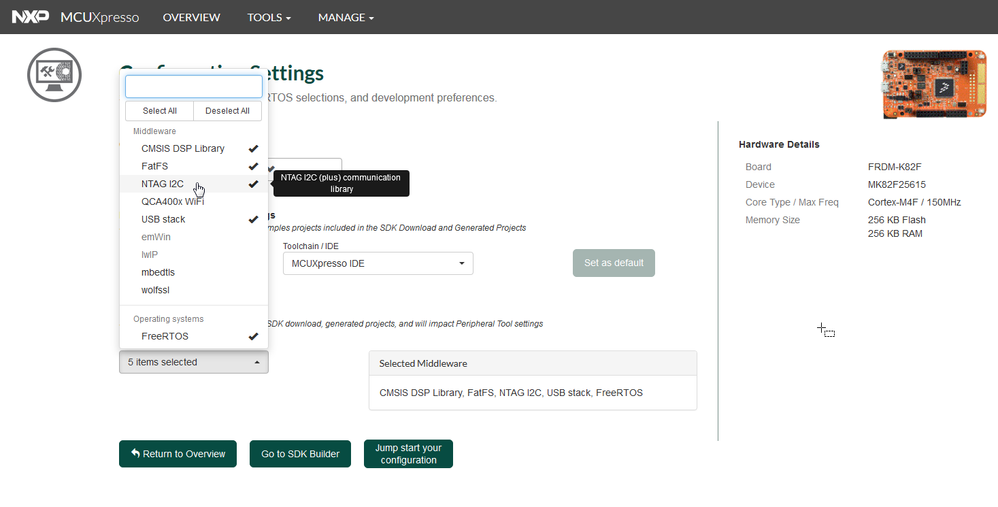

i am using NTAG i2c plus Flex Kit, and i would like to have a sample code on how to use it with FRDM k82f.
Thank you,
Chadi SALIBA
11 返答(返信)
8,345件の閲覧回数
Kan_Li
Please go to https://mcuxpresso.nxp.com/, and select NTAG I2C support as shown below, then you may download the latest ksdk with NTAG I2C plus demo.
Hope that helps,
Kan

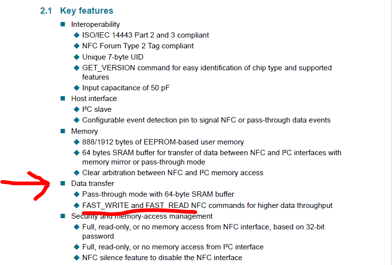

chadisaliba
Hello Mr Kan LI,
Yes, i have 2 FRDM k82f Kits and 2 NFC antenna Ntag I2c, and i want to exchange Data between them.
I chose this NFC device after i read in the Data sheet that i can write and read . Kindly find attached a screen shot of page 2 in the Data sheet of NT3H2111/NT3H2211.
If it is impossible to exchange data between the two kits using NT3H2111 of ntag i2c, do you have any suggestions on what can i use so i can make this data transfer between the kits.
Chadi SALIBA
8,345件の閲覧回数
Kan_Li
Hi Chadi SALIBA,
Replace one NTAG I2C with a NFC reader IC should make this application possible. Alternatively you may use two NFC reader IC and make them in P2P mode.

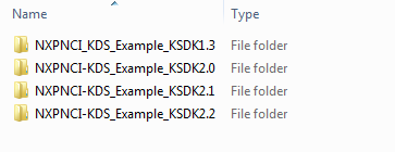

If you prefer to NFC reader IC, I would recommend PN7120 or PN7150, there is also a FRDM-K64 demo available to work with either of them in P2P mode, you may download it from https://www.nxp.com/webapp/Download?colCode=SW3735&appType=license&Parent_nodeId=1464843492338729907...
The demo is based on the latest ksdk 2.2, so it should be easy to port to FRDM-K82F. Please refer to the following for details.
* Support for all NCI based NXP's NFC Controller (e.g PN7120, PN7150)
 * Support FRDM-K64F NXP's Microcontoller Units
 * Based of KSDK 1.3, KSDK 2.0, 2.1 and 2.2

Thank you for the link, i already have this demo examples, but what i
need is just a basic code for sending information using the NFC Ntag i2c
kit,
and another for receiving.
It is very important so i can progress in my development.
