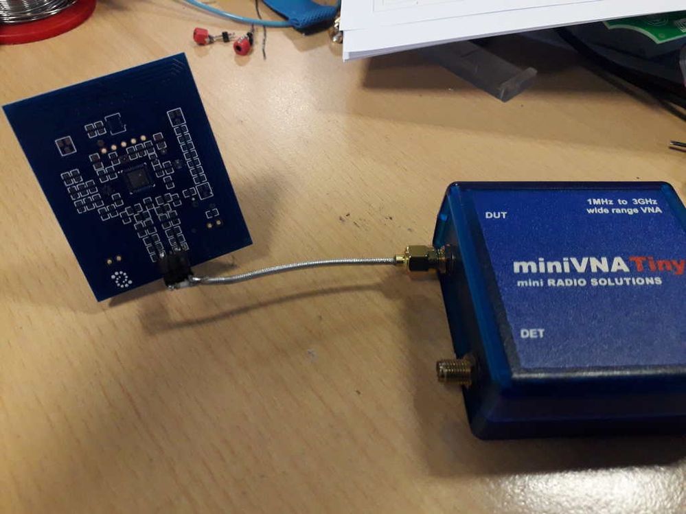

First I calibrate the VNA with a coaxial cable.

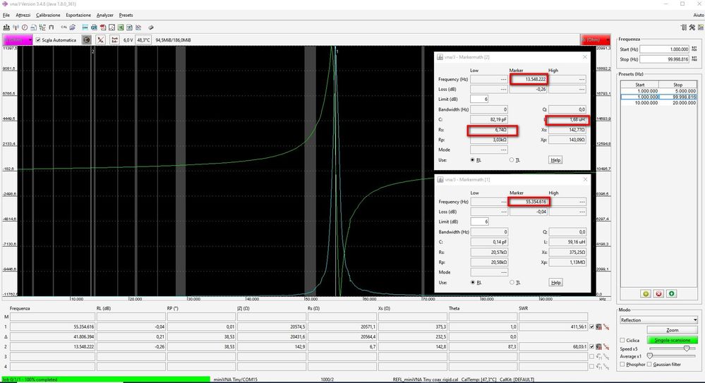

I measure the parameters and resonance frequency of the antenna directly on the dump resistors.
The parameters read by the VNA are:
L = 1.68uH
R = 6.74Ω

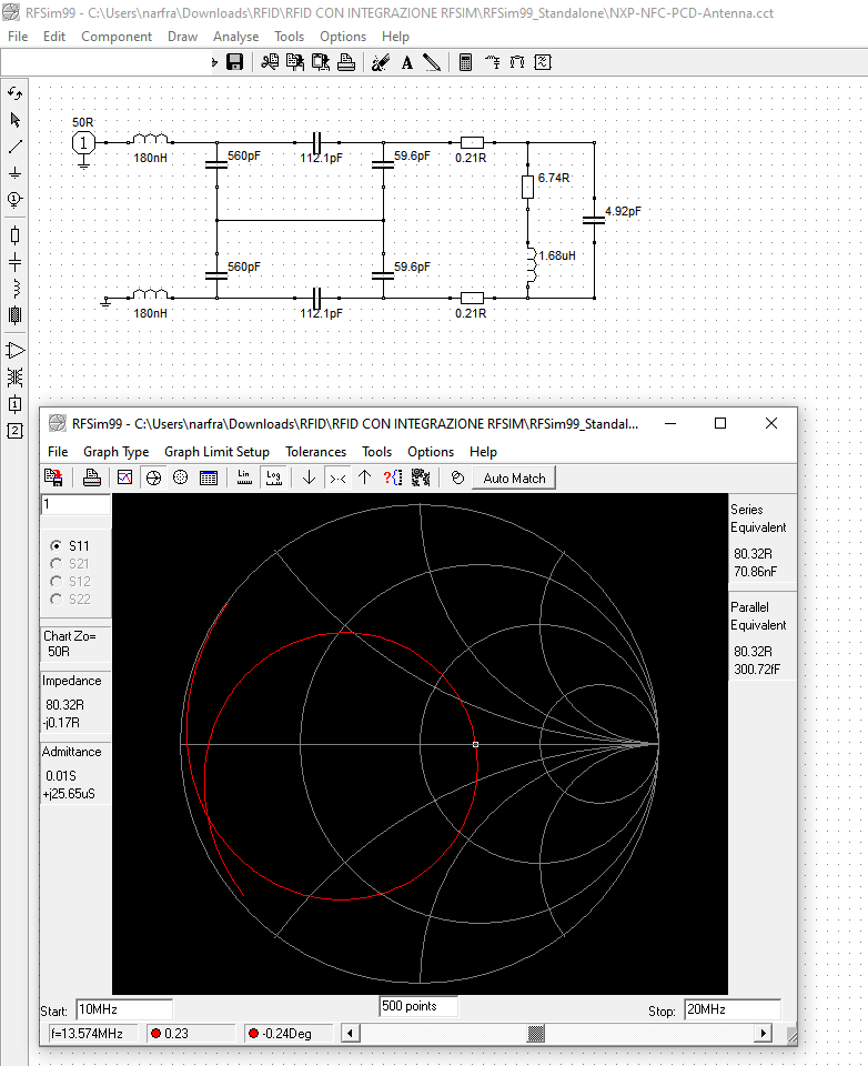

The simulation:
But I measured:
What am I doing wrong?

Hello Francesco,
I tried to simulate your circuit and I can see approx. the same:
btw. I always put something like 1.25Ohms in front of the inductors which simulate the inductors and connection losses.
About your topic, I see the resistance of your antenna is 6.72 Ohms. That is quite a lot. Do you really measure the antenna itself? Or did you include the damping resistors as well?
Once I decreased the Rs of the antenna, the results were more realistic
Tomas

Franz75
Hi Tomas,
the rs value was actually very high and as you can see from the photograph the dump resistors were not present. but by doing the same things again with the same "instrument" I now read 3 ohm... most likely the small VNA is of poor quality. Now everything works.
Thank you very much
