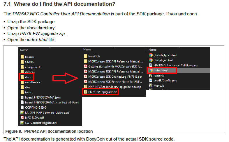

Please open the API User documentation.

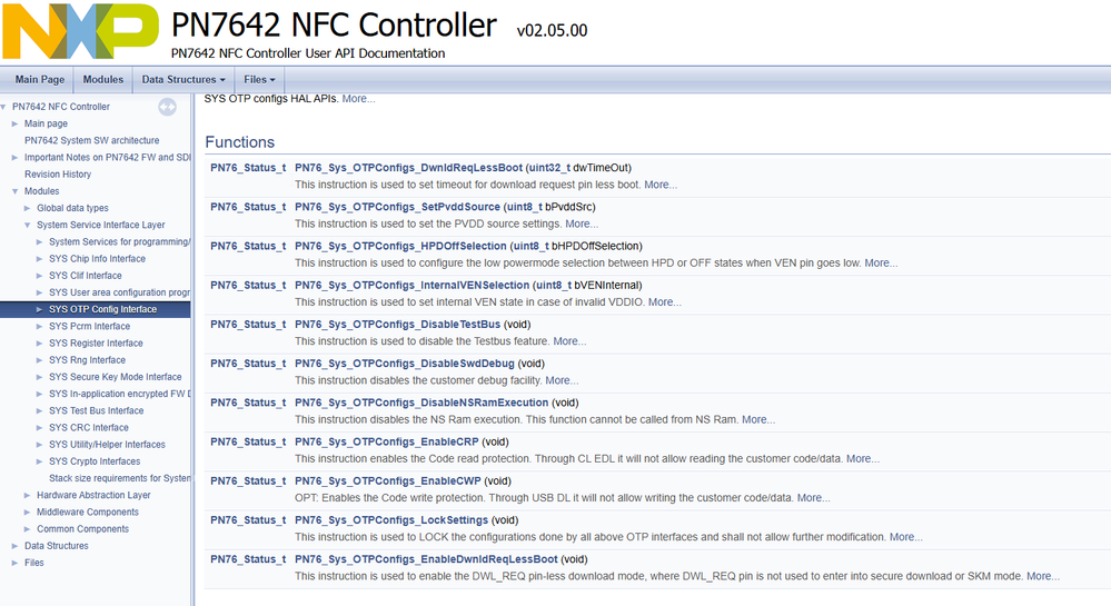

Then go to the OTP (One Time Programable) calls:
You could find all kind of security features to protect the chip such as Read protection, SWD disable and so on.
