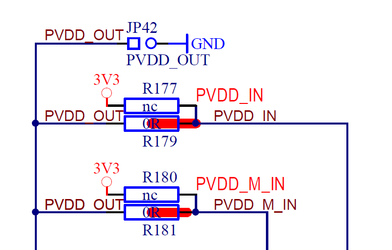

amolborase
We have make one change in hardwre that PVDD_OUT is connected to ground and PVDD_IN and PVDD_M_IN is connected with 3.3V externally.

Kan_Li
Hi @amolborase ,
It is really strange, anyway the results from my side are always in uA range, and I am wondering if it is due to some board issue or soldering issue on your side. Do you have another custom board to compare the result?  and if you test with the board of PNEV7462B, you may easily apply the same power supply configuration on JP42,R177 and R180. Please kindly refer to the following for details.
Kan
