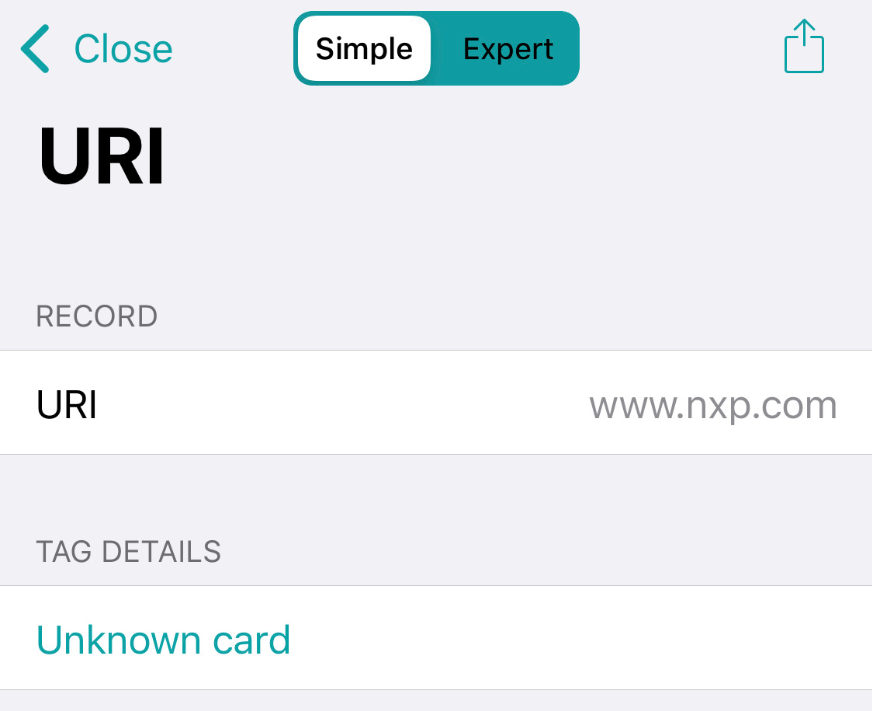

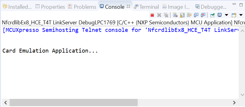

Hi @marcinbaliniak ,
Actually there is no such kind of issue on my side , just place iPhone close to the antenna and you will find the card is detected. but I didn't see so much logs as shown above, did you enable some compiling option additionally ? That would consumes more time so that it might cause some timing issue according to the spec. Please kindly refer to the following for details.
Kan
