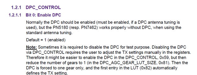

I'm using PN7462 in my project.
I want to disable RfPower "Dynamic Power Control" feature.
It looks like this feature is controlled by bit0(DPC_ENABLE) of 'bOcProtControl' byte in phCfg_EE_HW_RfDPC.
But I don't want to generate a new eeprom file and burn this eeprom into my devices.
What I want to do is no matter what is written in the relevant section of the eeprom file, this feature should be turned off at the beginning of my firmware.
How can I do this?

Hi @EE_Ark
I would suggest you refer to AN 11742,  there is a DPC_CONTROL register responsible for enable/disable DPC function.
